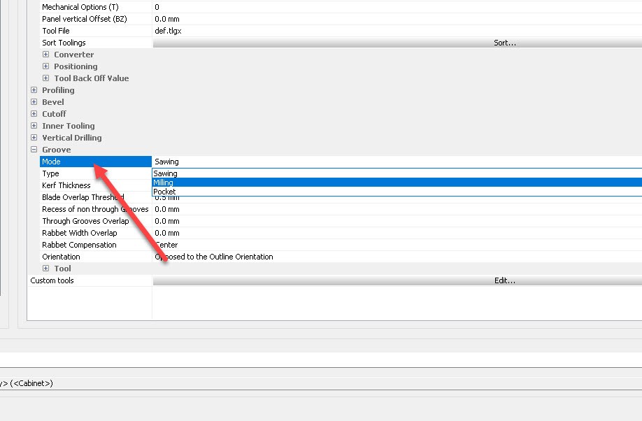

February 26, 2026 - 11:39 am
Hello Hassan,
Yes, this can be done.
In your PostProcessor set up, change to the desired grooving mode:
1.jpgImage Enlarger

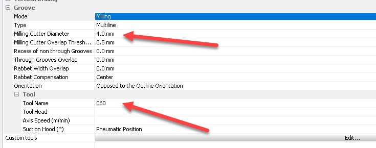

Then, you will need to set the tools’ name and diameter:
2.jpgImage Enlarger
I hope this helps.

Thanks Isaac,
By the way I wonder how can i replace the grooving with the router instead of the saw?
is there a way to make it default?
