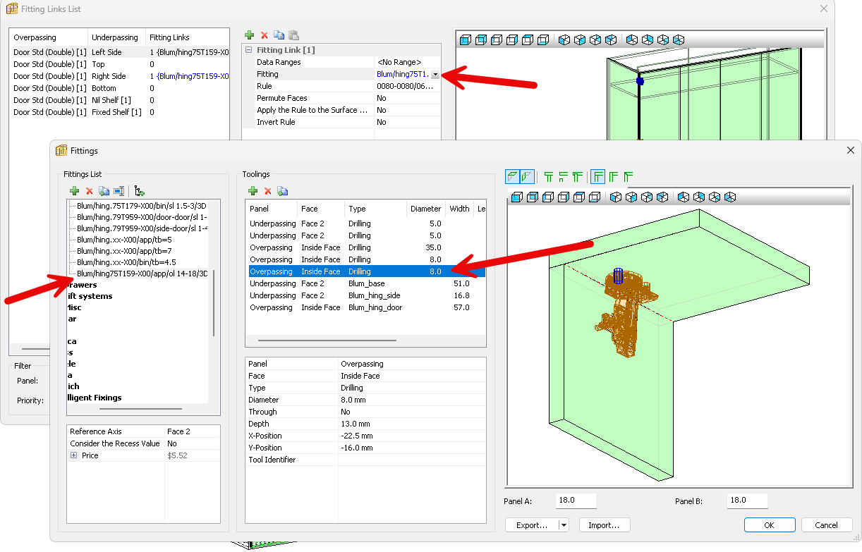

Tom,
See the following image. When i access your fitting links, the hinges you are using have an 8mm drilling. You must be looking at the wrong hinge in your fittings. I recommend changing its name so that it is easier to recognise.

When exporting my project to OptiNest, I noticed an issue with the bi-folding doors that use two hinge types: our standard Blum 110-degree full overlay door hinge and the newly added bi-folding hinge. The problem is that the screw holes on either side of the 35mm bucket drillings are different sizes, as shown in the attached image.
According to my hardware specifications, these holes should be the same size. Why are the hinge plate circles appearing at different sizes in the output? What am I missing here?
