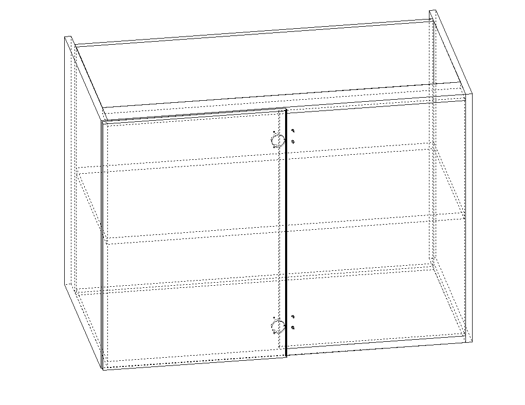

June 16, 2025 - 11:21 am
Hi Dean,
Please find explain and fitting you can import, please make test before final panel to be sure
Kind regards, Alex

June 15, 2025 - 12:21 am
Hi folks,
  Bit of a tricky one. Please see attached picture with something I would LIKE to add to my fittings links list. At the moment I have added these using internal tooling on a single panel. The only issue with this is it does not export to vCarve as drilling, but wants to pocket them… even the little 3mm holes.
The hinge I am trying to add is this; [Subscribe to Premium Support to view this media]
Is there any way of either;
1) Adding this using Fittings Link? This is preferable, however I cannot seem to link the free division to the frontal.
2) Changing the preffered method of tooling from pocketing to drilling?
DeanUntitled.pngImage Enlarger
