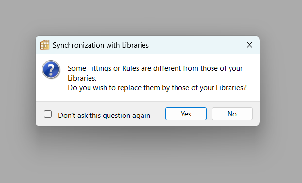

Thank you for information. I did this from the first time I open v8.01. Still some issues, but I will try to to work with what is available to me in new version and start building new.
My biggest problem, and was never addressed, problem with language inside the installation that should be English and it is not. I sent a few screenshots in the previous notes. I need to guess what all these means when I open v8.01 to work. Can you or Alex can explain how the original installation installed French. I had try to change languages, noting change

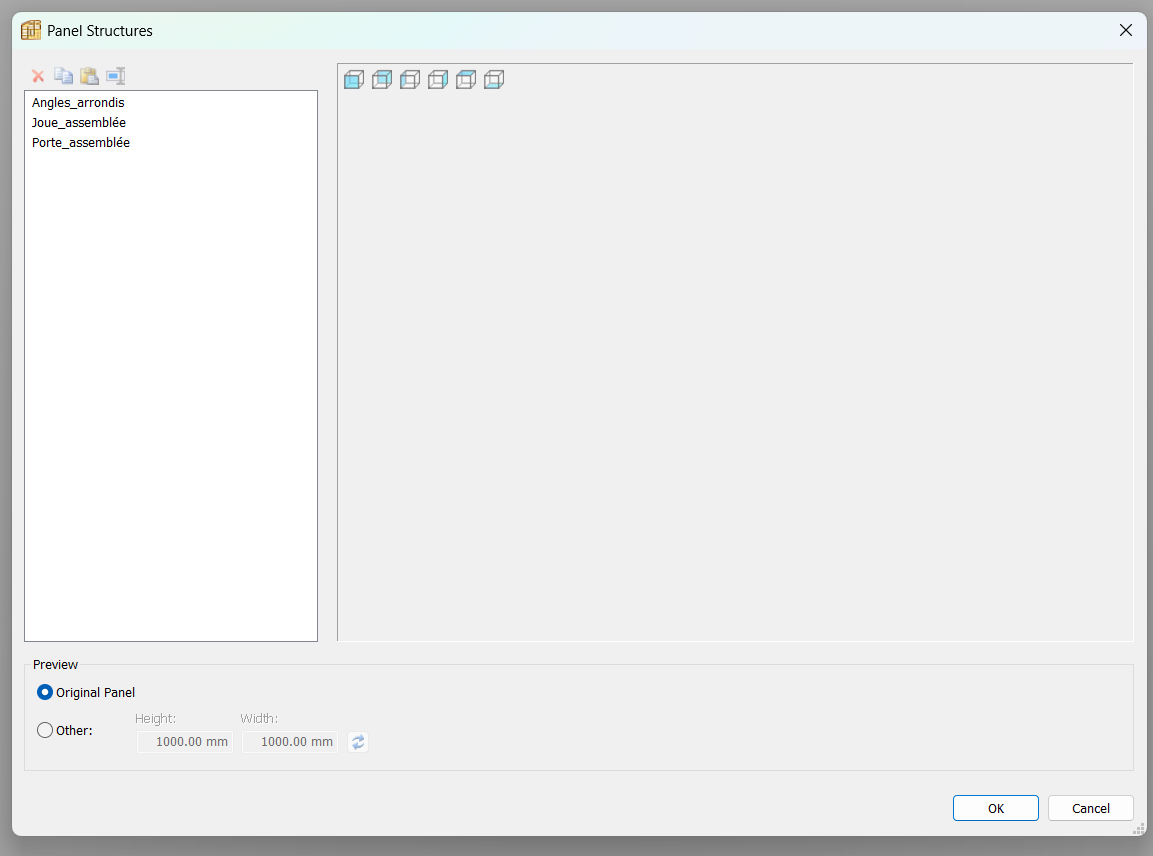

Hi again, still my system is sending me error after all is back. Again, why I have French inside my installation>???????PIC4.pngImage Enlarger

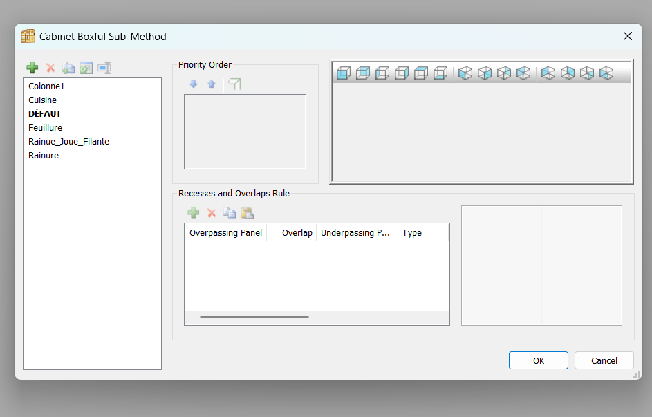

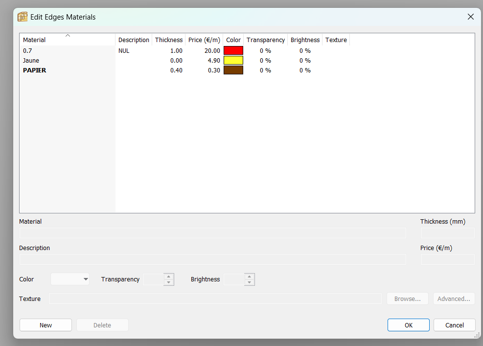

I am trying to work with new version of Poly8 but i am heaving lots of issues. Original installation language is English, but nothing inside is in English. No proper startup data base, no proper file structure where I can import files, fitting links are not in English….
No Post processing data bases?!
Any suggestions????
I need to continue using my program, but…….
ZackPIC1.pngImage Enlarger
