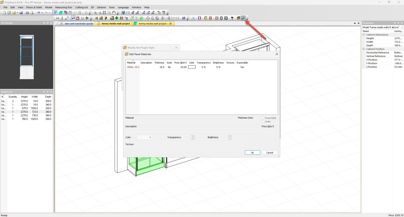

Hi Ben,
Normally you can use the Modify Styles tool and change like materials in one application. See the following image:
Modify-styles-tool.jpgImage Enlarger
But, since you have drawn the entire project in a single material this is not possible. You can use this method but it will change the entire project.

how to change material for project without going into each cabinet to change individually? i want to know if this can be done i have attached a project below which i would like to change
