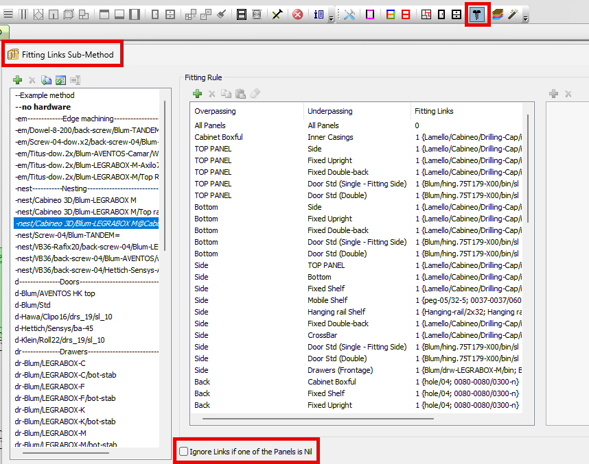

Or make sure that the option in the Fitting Links Sub-Method: “Ignore Links if one of the Panels is Nil” is unthicked. This way, even if your side panel is a Nil panel, the connectors still remain.
fitting_links_sub_method.pngImage Enlarger

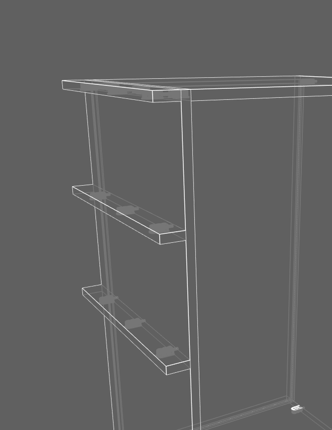

For the cabinet on the right, add a external zone to the left with the width of 50mm (make it a “Outer” zone in order to keep your cabinet final dimensions) and add fixed shelves at the same exact heights as the shelves from the cabinet on the left and add the connectors between this panel and the “fake” panel shelves.
fake_exterior_shelves.pngImage Enlarger
The main idea is to “simulate” for each of the cabinets the panel/parts of its interconnected cabinet.

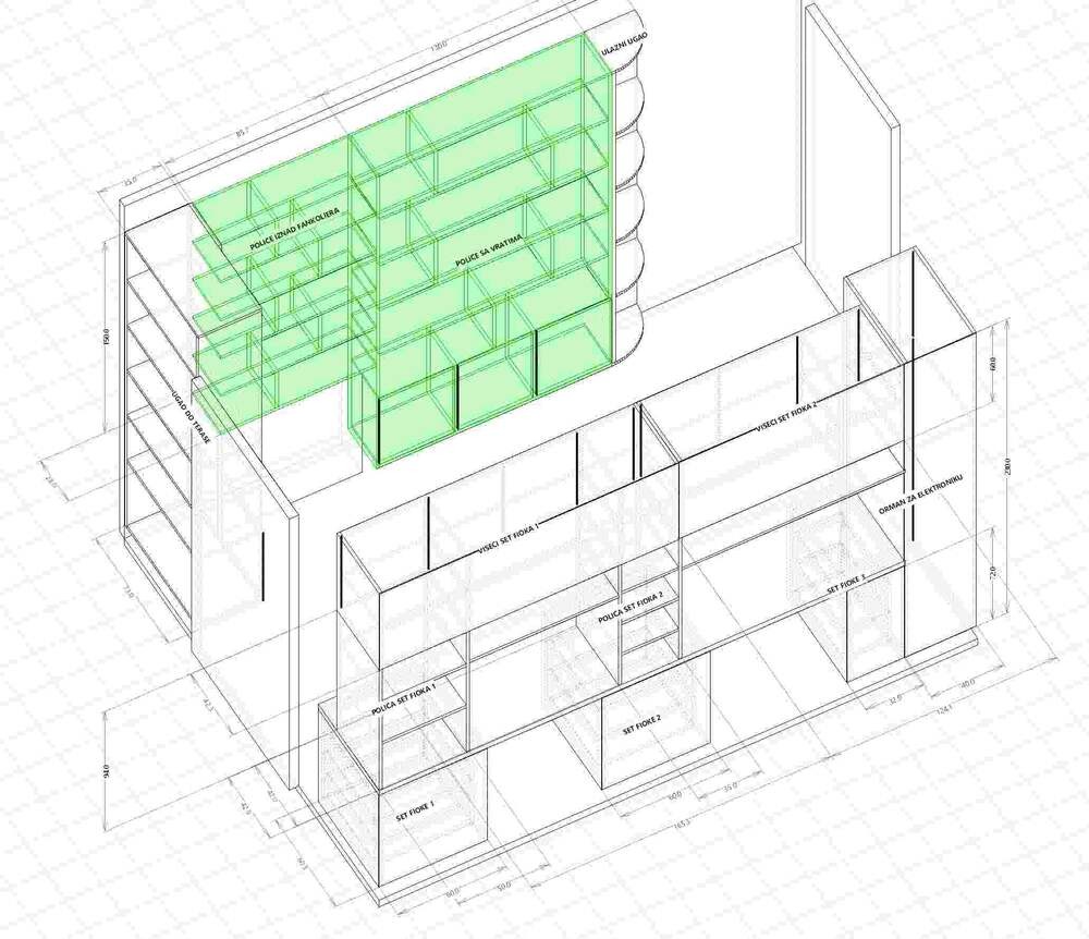

I am looking at possibility to connect two different cabinets in the project and to have associated connectors in between two units, and to transfer to the dxf/CNC output. Is it possible to have that ( I know it was not possible in the past). I am working with Lamello products and need to transfer connection to double sided CNC machine. Attached is the Project and in the green highlighted are two parts that I need to connect. I didn’t want to make one whole unit.
total-view1-1.jpgImage Enlarger
