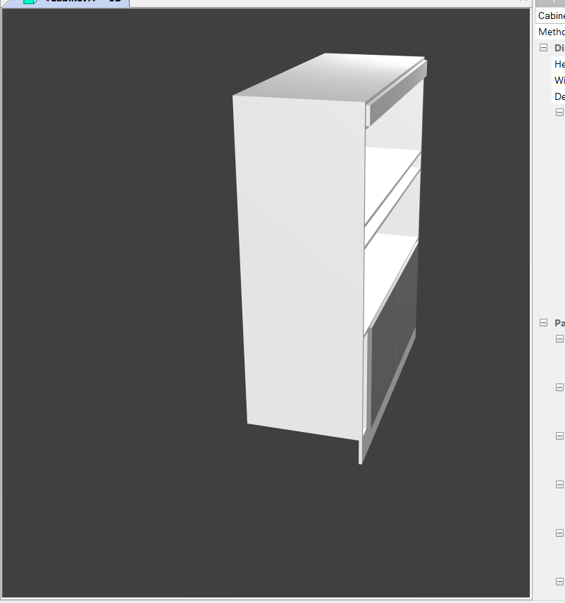

right so i think i have figured the nil shelf i used it like you did in the video and brought the false back to front with overpassing top etc but when i go on the 3d image it appears to be no shelf underneath so im guess the nil shelf is essentially no panel ? i need to have an underside to the face panels as customer is having downlights so need a void to all for this.

January 27, 2025 - 3:06 pm
hi isaac, do you have to put it as a nil shelf to allow to modify to overpassing ? will a nill shelf be the same material as the rest i just get abit lost with all the different types and the reasoning behind them but will learn with time

would it also be possible to show how to oversize individual panels for example a shelf that is being used as a worktop but i want it to be 20mm deeper to sit flush to door fronts. and also for the side panels of the unit to be oversized by 30mm to account for skirting so that i can notch over and sit the unit back to the wall without taking the skirting out.

January 26, 2025 - 10:17 pm
hi im currently trying to knock up a media wall design. i have made my unit but i need to make a face frame along the rails going across, you can see in my picture i have created one by using the double back feature but as you can see it doesnt sit ontop of my 2 shelves it is sitting inside. im sure this is just a ruling i need to change or make but not sure how to go about it.
