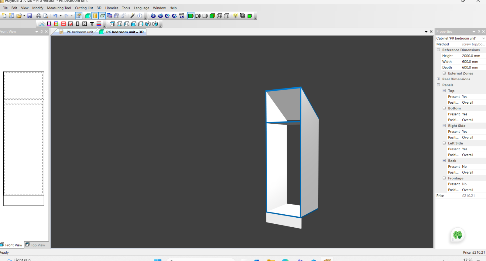

ah okay i understand this. one question so when i go to optimes cutting list to opticut is the split shelf (hanging rail) going to be on my cutting list as an item or not ? obviously i dont want this to be on there.

January 25, 2025 - 5:32 pm
Screenshot-2025-01-25-172845.pngImage Enlarger
i would like to know how to input hanging rails and hanger in wardrobe for design
