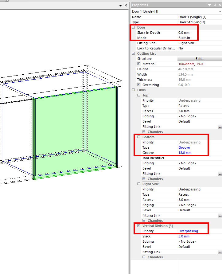

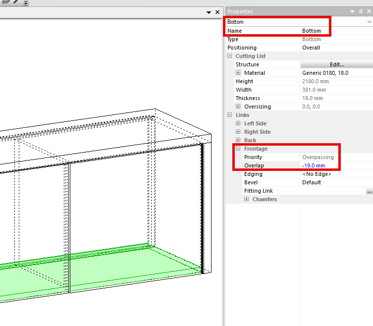

Hello Emmanuel,
The only way I have managed to reach the design mentioned above is to add Built-In doors and to trick Polyboard that they are grooved into the bottom panel. But since the bottom panel it is recessed 19 mm (the thickness of the doors) there is no groove in the bottom panel.
This way the doors are built inside the top and side panels and overpass the bottom panel. For the uprights (intermediary panels) just select the doors and change the Priority to Overpassing.
See the images below for more info:
fix_3.pngImage Enlarger
fix_4.pngImage Enlarger

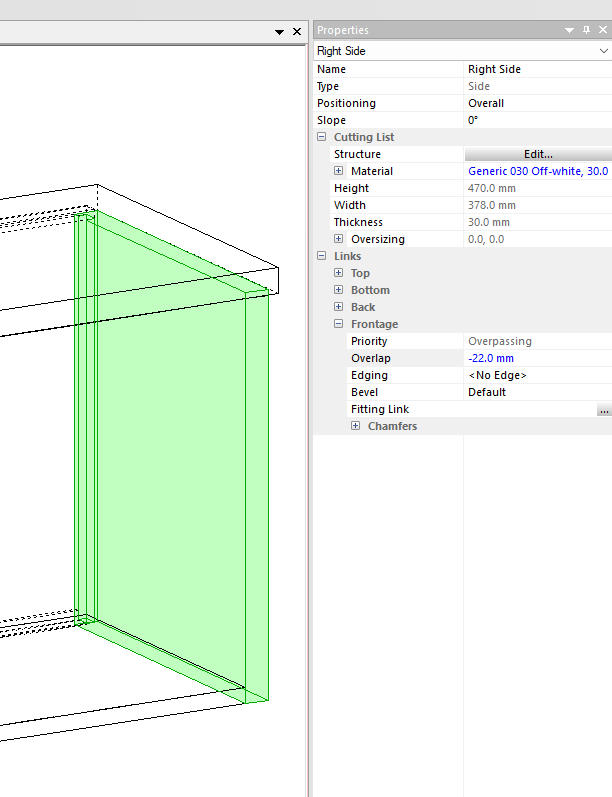

Hello Emmanuel,
I have tried and applied a recess of -22 mm and it worked.
fix_1.pngImage Enlarger
