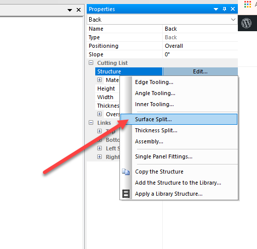

okay can you show me a video of using the surface split to the measurement i want say if i wanted to split my back into 3 sections 2@ 300mm and 1 @1500mm as when i go to surface split it asks how much slack i want and removes this i cant actually say type in a measurement and apply a 0.1mm slack to create a individual back piece

Rather then overpassing the shelf to the back panel, you would be best to leave it as underpassing. To then split the back for multiple cabinets, you could use the “Surface Split” feature.
2026-04-30_11-19-12-1.PNGImage Enlarger
Additionally, If you do not want the shelves to split through multiple uprights, you will need to add them separately as two different uprights instead of using the “thickness split” feature.
