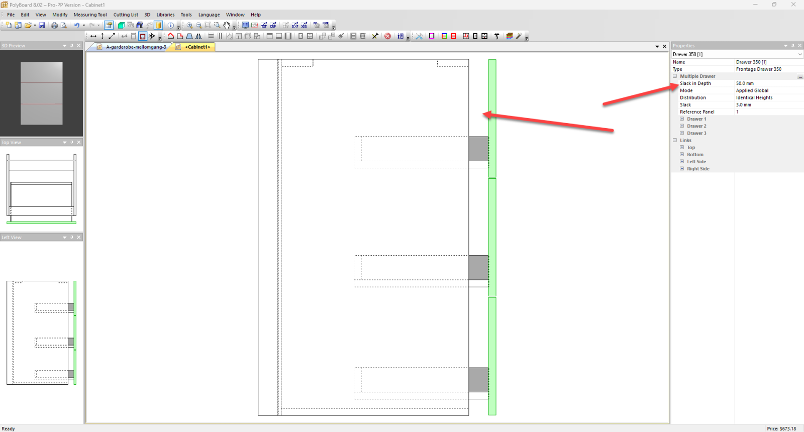

The depth slack is setting the distance between the drawer front, and the front edge of the cabinet. This is reversed into the cabinet for built-in drawers.
Slack-in-depth.pngImage Enlarger
The drillings for your drawer components are set in your fitting links sub-method.

Sorry, can see how that can be confusing… I try again.
the in depth slack is set to 2.5mm. But when we make the drillings for the drawer runner its placing it so that the drawerfront ar 7,5 mm from the front insted of the 2,5.
Maby I missunderstand what the in dept slack means…

Ola svensson
Forum Posts: 100
January 20, 2022
September 24, 2025 - 4:02 pm
Hi.
Can you pleas advise why the actual drilling make for a 7,5 mm in dept slack when the in dept slak in the drawer sub method is set to 2,5mm
What do we miss:
Best regards Ola
