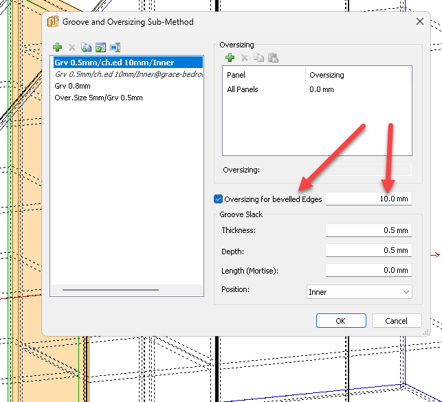

Hello Ben,
No problem. This setting is automatically adding 10mm of oversizing to any angled (chamfered) component. To remove this, you can change this value to 0mm, or just un-check the tick box for this setting.
This is for manufacturers who want additional oversizing for chamfered components only.

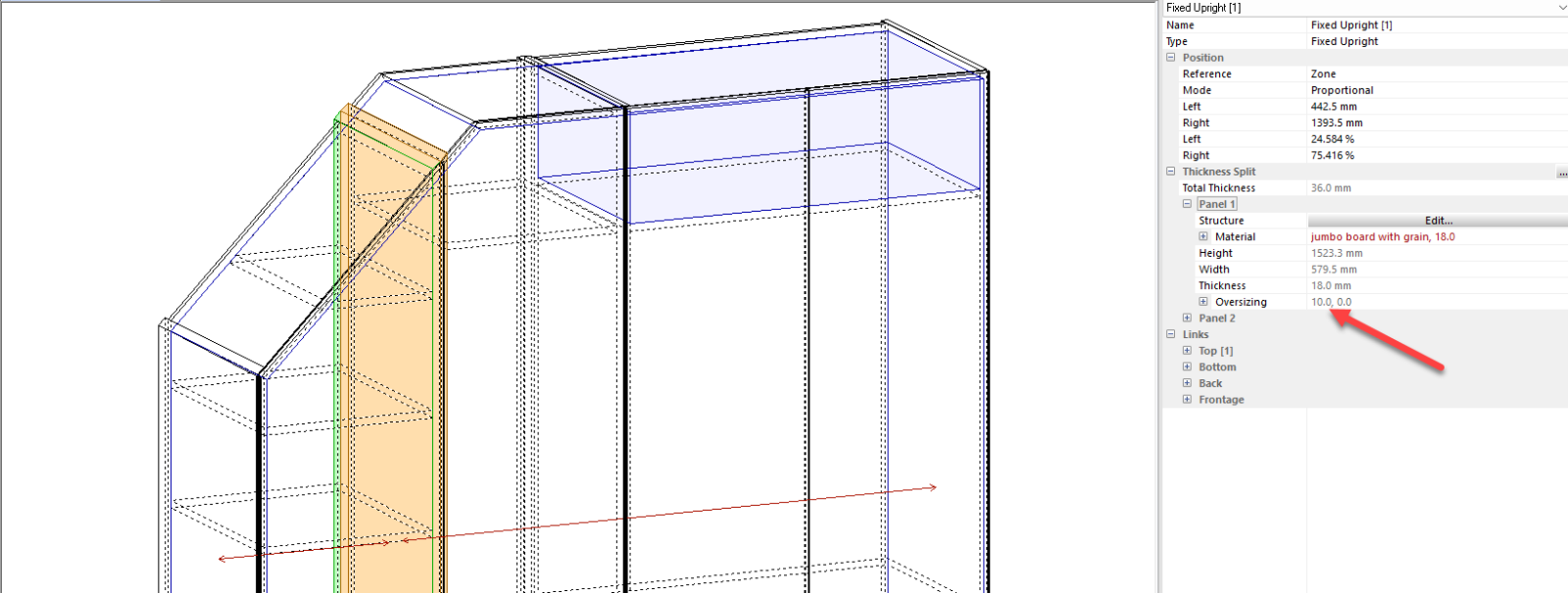

Hello Ben,
See the oversizing applied to the components.

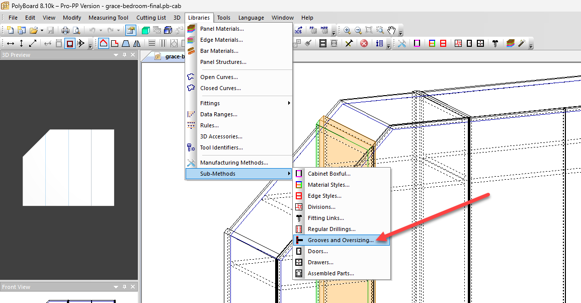

If you access your sub-method for grooves and oversizing, you have 10mm applied to all bevelled components.
2026-05-05_09-36-35.PNGImage Enlarger
2026-05-05_09-37-27.PNGImage Enlarger

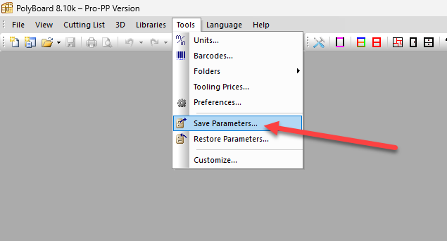

Ben,
Your parameter file is found as follows:
2026-05-05_08-11-45.PNGImage Enlarger

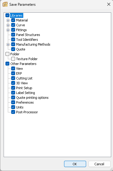

Please do not save your textures to the parameters file, as this is not needed and will only increase its size:
2026-05-05_08-12-12-1.PNGImage Enlarger

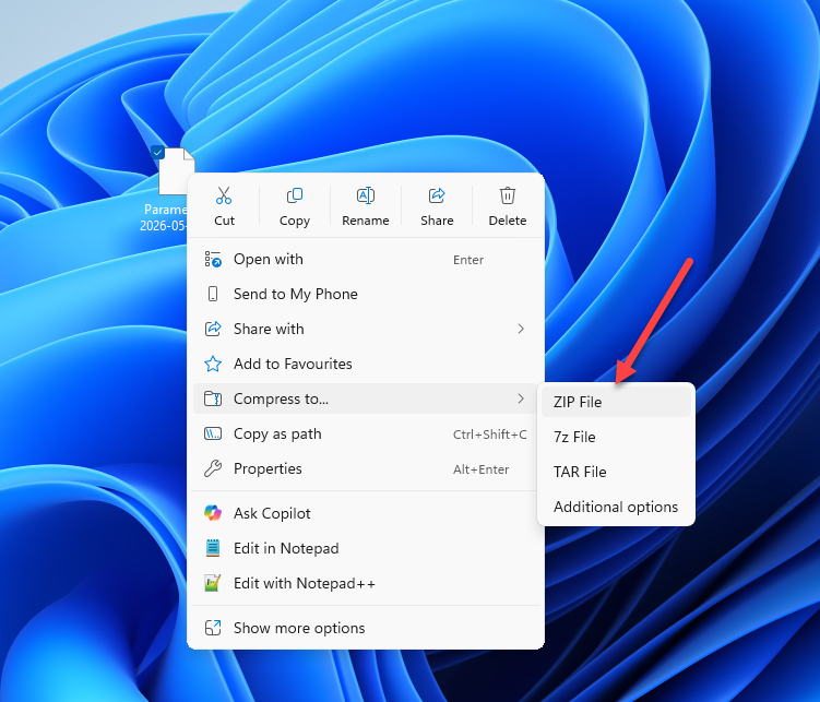

Finally, if it is still too big please compress the file to a zip folder and then upload to our file uploader:
File uploader
2026-05-05_08-14-24.PNGImage Enlarger
