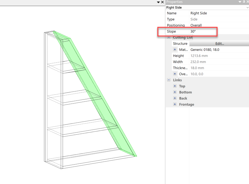

no i understand this but i want to angle the cabinet so essentially pivot the left or right upright the job is a counter which has 3 faces front angled side and side if that makes sense
Forum Posts: 1452
January 13, 2026 - 9:58 am
Hello Ben,
Are you just trying to slope one side of the cabinet? I have attached an image example of what you can do.
If I have not understood you properly, please could you send me an image of what you are trying to achieve.
Sloping-cabinet-sides.pngImage Enlarger
ben levene
Forum Posts: 69
December 13, 2024
January 12, 2026 - 9:30 am
hello i would like to know if its possible to put an angle thru the whole unit. i will attach a file of the unit but essentially i need a 30 degree straight cut thru the entire right side from top to bottom so that i can butt up the the other unit. the unit is an extension of a counter (the extension needs to be coming of the counter with a 30 degree angle.
