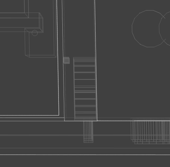

Good morning Emanuel,
What is making this challenging is that you are using the Q-fix fitting, a 3-axis fitting, with a 3-axis CNC, although require 2 face drilling on many of your components.
My recommendation would be to take the time to properly set up a few manufacturing methods with the goal of having you fittings 80% completed for your custom projects by the time you have added all of your components.
The more you can automate your fittings in the software, the less time you will need to spend checking and moving fittings between faces manually.
I hope this helps.

Hello Emanuel,
See the following image, the holes for the Q-fix, and drawer slides are on different faces.
