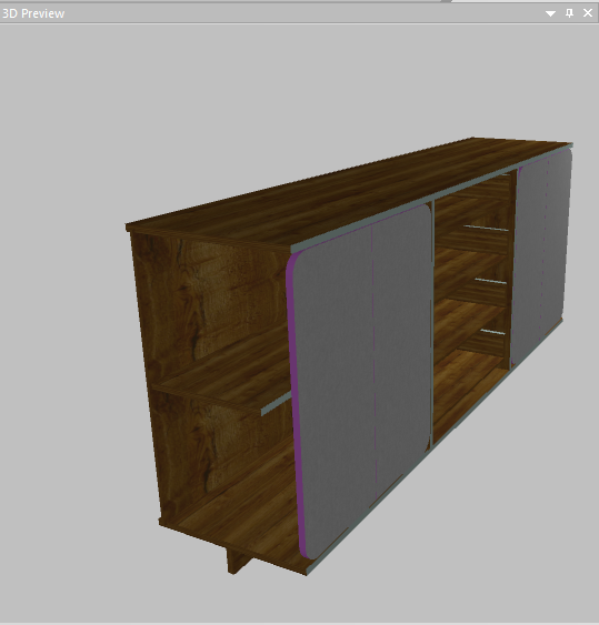

I have figured out the thing that makes parts disappear, it`s applying saved structures specially the ones that contains angle modification also if i made it manually it disappears.
Hassan Sultan
Forum Posts: 39
May 14, 2025
June 28, 2026 - 8:08 am
As you can see from the reference attached, there are also panels that are not visible in the 3d view port.
I have downloaded 8.11a version, which has a lot of bugs and crashes and this is a serious problem that we can`t come over.
Also I can`t go back an older version, it looks hard and a little bit dangerous after the long journey setting up the P.P.
please contact me ASAP.

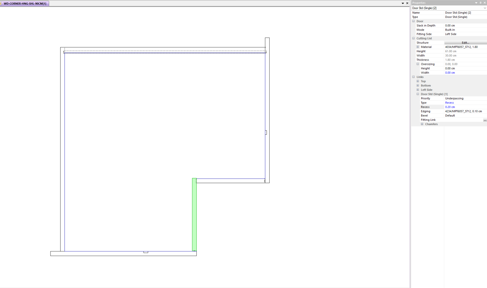

I have noticed an issue when i changed the doors` mode to built-in
as you can see from the reference i have attached it`s not responding correctly to the recess value, and it doesn’t accept negative values.
Kindly guide me to solve this.
