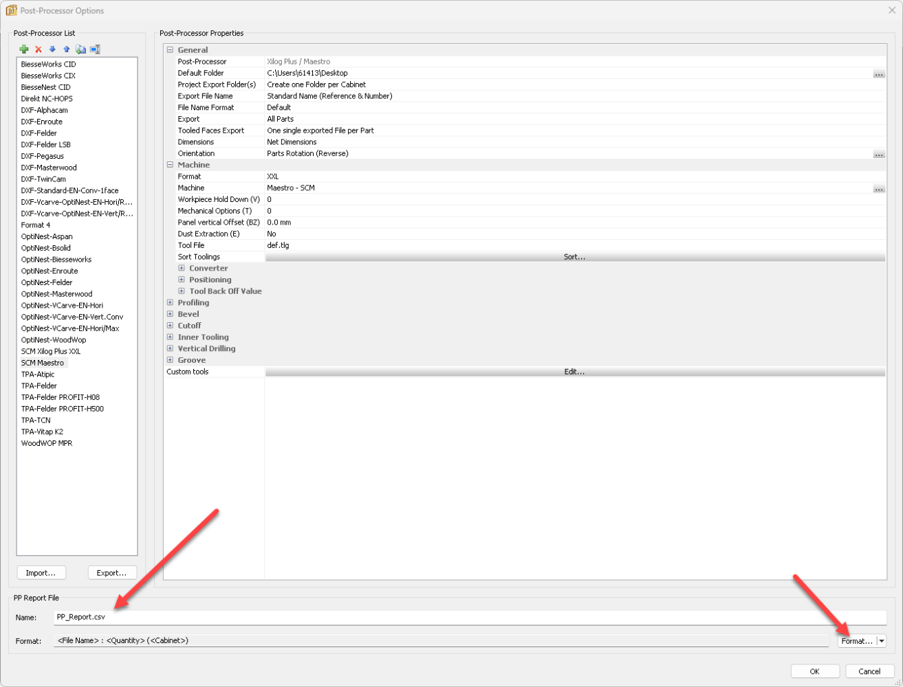

Isaac said
Andy,
Based on the documentation, it appears that Maestro supports importing a parts list via CSV, which should handle the necessary data for labelling—provided the file is in the required format.
To adjust the CSV format, first rename the PP report file extension to .csv. Once renamed, you can rearrange the columns and formatting to match the SCM requirements outlined in their document. Please refer to the image below for guidance:
Note: I have recently had the experience of working with a customer who was trying to conduct a similar pathway. He was informed by SCM that his machine and software package didn’t come with such capabilities and that he required to pay them for an upgrade. I have had other customers who can set this up without any problems. It may be worth contacting SCM to confirm capabilities, and the required CSV format that you need.
Hi Isacc
Its not worked, what can i send for you to have a look at? its also started flipping panels different way and doing the drilling wrong
thanks
Forum Posts: 1389
28
August 14, 2025 - 8:12 am
Andy,
PP-report-file.pngImage Enlarger
