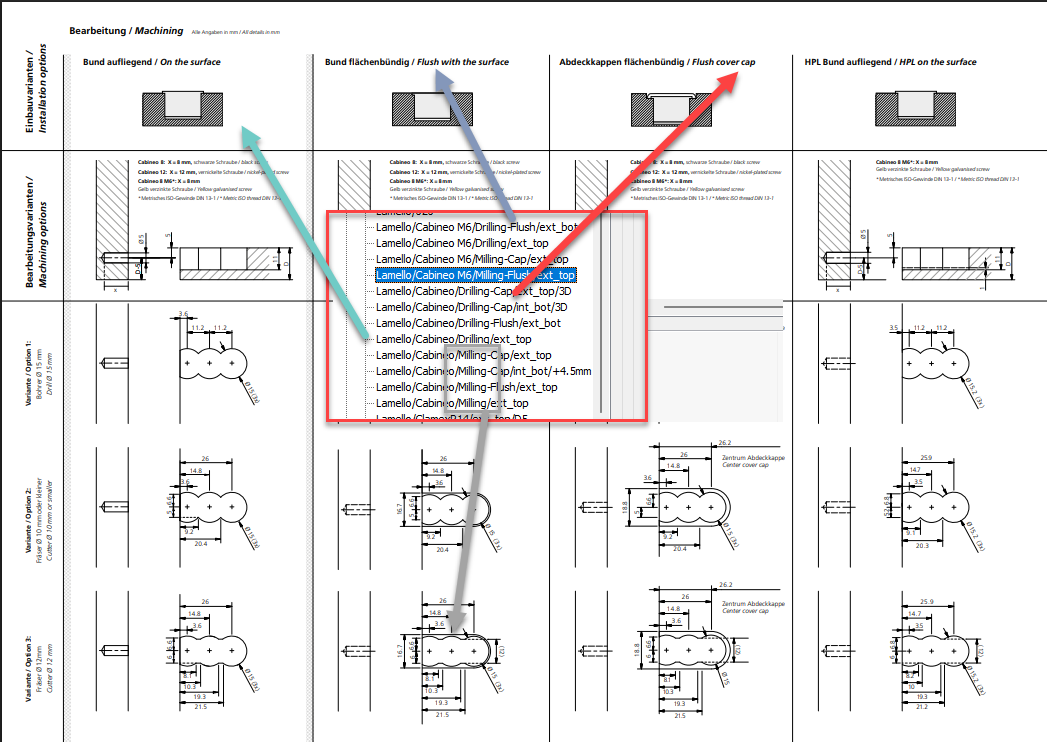

May 21, 2025 - 12:39 pm
If you don’t have them, I can provide them for you, from the attached xml file that you can download and then import into your library.
Please see picture below
Cab.pngImage Enlarger
Milling refer to cloud milling mode in grey
Drilling refer to the 3 drilling mode
Cap is Flush cover Cap
Flush is Flush on surface
If no one of these two instructions, it was the classic in surface mode
All the best Alex

May 21, 2025 - 10:53 am
Can you please advise on how to choose the different machining for the Cabineo cap?
can you please download this free files from lamello so that we can choose the different options from your library? or are they already there, just that we can’t find them.
We would like to choose how the cap is position on the surface, as shown in the manual it is 3 different options. [Subscribe to Premium Support to view this media]
