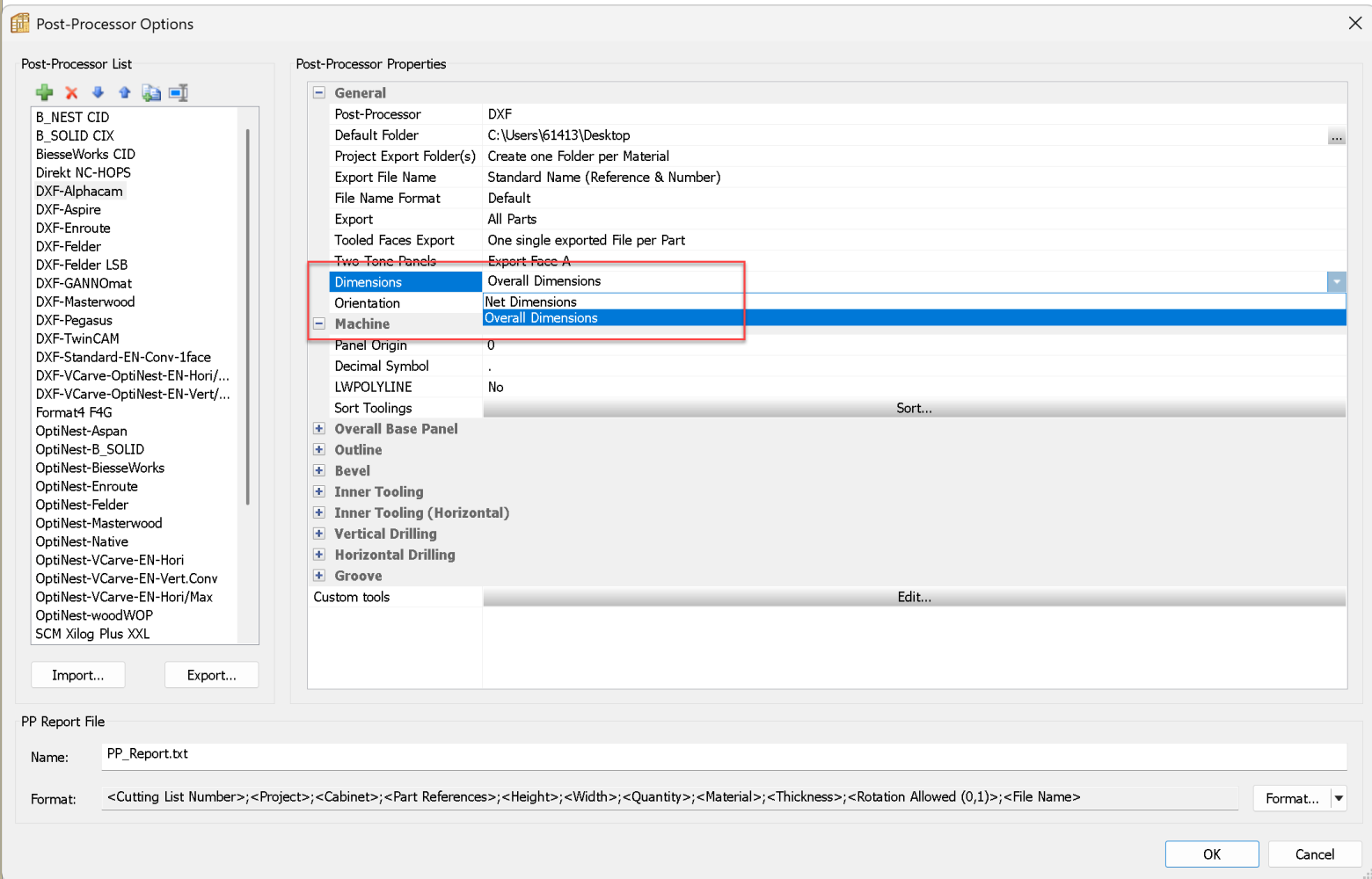

Hello Blaz,
This is found in your Post-Processor Options.
2026-05-04_09-04-39.PNGImage Enlarger
Overall dimensions: Panel dimensions including the thickness of the edgebanding
Net dimensions: Panel dimensions excluding the thickness of the edgebanding (this is what you need)
The same options can be found for the cutting list under Cutting List>Cutting list options.

hello
I am making a panel that has rounded corners and i need to edgeband by hand. so the machine needs to mill 2mm more in 3 sides of the panel fore the thicknes of the edgebanding so i get the corect dimension.
but when i add the edgebanding and set the thicknes of it to 2mm the dimension on the machine or in the file does not change it is the same when the thicknes of the edge is 2mm or 0mm there is no diference.
what do i neede to change
