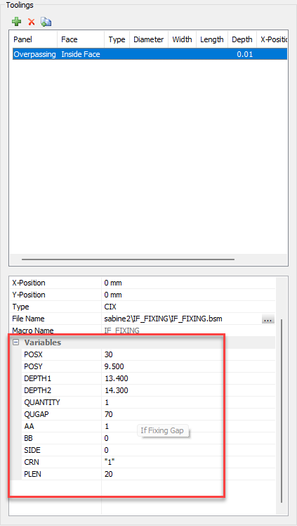

Macro is sub-program, which must be positioned per variable,
After restore your cabinet and setting
Macro-1.pngImage Enlarger
which means that whatever the rule, the macros will be called AND positioned with the same values.
subject to test, and work face, the position in X will then have to be indicated with the internal variable of PolyBoard “%X%”,
and Y with %Y%
/!\ Depending on the case and the working face, %X% and %Y% may be reversed, or even %X% OR %Y% may be used to give a thickness /!\
In screen shoot below you can find setting can be tested (for this macro direction look to be provider by variable AA or BB switched to 1 or 0)
Macro-2.pngImage Enlarger

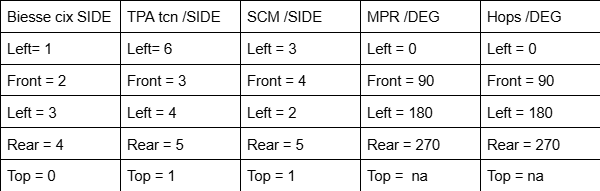

And PolyBoard internal variable table,
%X% = Position value in horizontal X from panel origine (bottom left corner)
%Y% = Position value in vertical Y from panel origine (bottom left corner)
%DEG% = Machining orientation in degrees, 0° Horizontal 270° Vertical in counter-clockwise Left edge direction is 0°
(excepted for biesse)
%SIDE%= Working face (please see table WS.png)
WS.pngImage Enlarger
