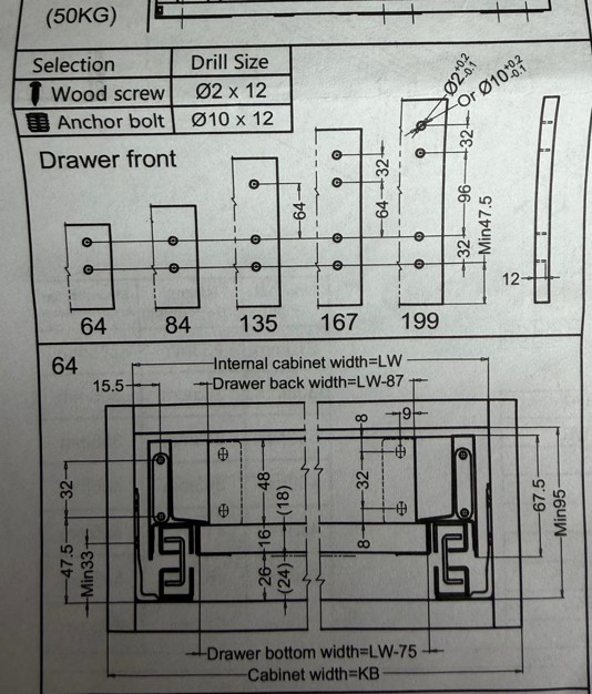

Built in please Isaac, just 1 drawer inside the box so I don’t waste so much materials, then I can test these 167mm sides into a working model to test. If all works out and we’re happy we’ll then proceed to the next step which will be setting up a session to understand how best I can work with and manipulate these drawer boxes.
find attached an image of the drawer face screw holes based on side heightMatrix-S-Drawer-face-holes1.jpgImage Enlarger

I can adjust the front. Please send me the measurements for the front drilling and i will add them in.

Could you make it so its just the 1 drawer please? When i try to remove a drawer all the tooling etc disappears. For some reason my drawer face tooling ends up on the sides??? Also it only appears to show 2 drill holes the the drawer face in your version. My understanding is that there are x4 holes on the drawer face at 167mm height? If you could make that change that would be great!
