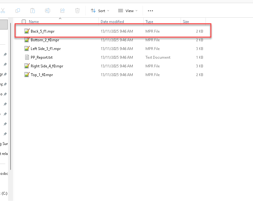

Hello Isaac,
We found the issue. We usually use Multiple PP export, and for some reason the box for back export was not marked in Multiple PP settings.
Thank you,

Using your provided cabinet, parameters and PostProcessor I have tested this.
On my first test, you can see that the back panel has exported to an mpr. file.
Are you not receiving an mpr file for your back panel?
