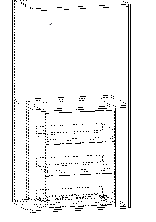

Hello Dean,
The best way to do this is in the project mode.
You could create this in the cabinet mode, but you would need to manually draw a cabinet within another. For example, you would make the sides of the internal cabinet from uprights, the top and bottom from shelves, and then add the drawers.
2026-07-06_10-07-14.PNGImage Enlarger

Can I insert a pre-organised model, into another model in CAB mode, not project?
Like it I wanted to insert a set of draws or would this need to be recreated?
