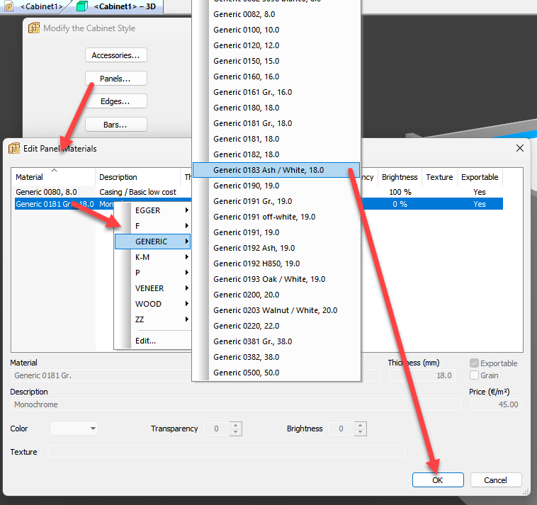

From style wand (Modify the cabinet style > Panels …), Right-click on the panel you wish to modify to open the list of materials. After selecting your material, remember to click OK to complete the process.
sty.pngImage Enlarger

Modify style, Panels
I am trying to modify a cabinet from generic 0180 to generic 0181. I normally select the Modify style wand, select panels and right click the mouse to change but the right click is only highlighting the line and doesn’t give me the option to change it over.
Any suggestions? Might have something inadvertently selected on the keyboard but cant figure it out.
