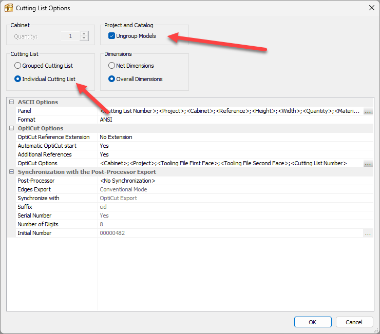

Great stuff, thanks for that Alex.
Yeah the “ungroup models” option was unticked in my cutting list options, I must’ve accidentally done it.
All sorted now,
Thanks again,
Sean.

Can you provided more explain about your process and PP used?
Before having more detail, depending your exporte setting, and PP,
All software don’t manage quantities, when you have same cabinets or multiple parts ,for example in Nesting with DXF > to CADCAM like Vcarve (without Opines, because OptiNest manage quantities) or SCM Maestro Nesting, a and you need to specify this from Cutting list Option
indi-and-ungrp.pngImage Enlarger
Hope that’s helpful, Alex

Hi, I’ve just noticed recently when in a project if I have multiple of the same cabinet and then export the whole project, It only exports x1 of that cabinet.
I didn’t consciously change anything with the settings or change the way I do anything but it’s only started doing it in the last few weeks.
Any help would be appreciated,
Cheers,
Sean.
