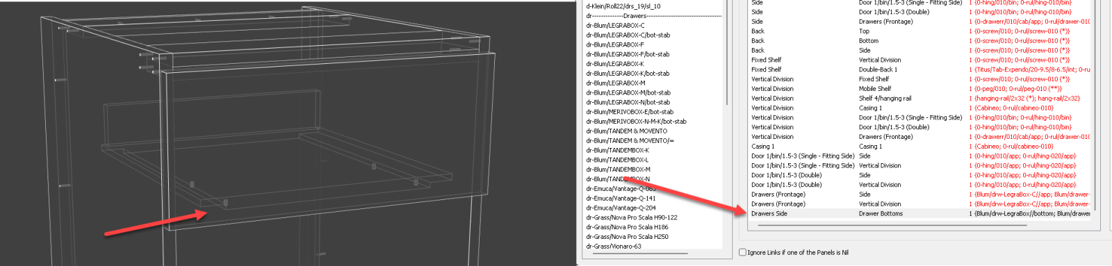

Hello Caroline,
The “additional panel” on the drawer bottom is actually a groove tooling that is used for the Blum Legrabox system.
This is currently in your fitting rules, find the line highlighted in the following image and remove it. This will remove the grooving on your bottom panel.

Hi Isaac
can you take a look at the attached unit,  i have done the kubox runners and added a 450 drawer but underneath the bottom of the drawer there is an extra panel??
