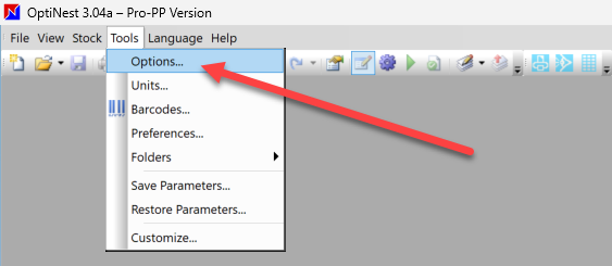

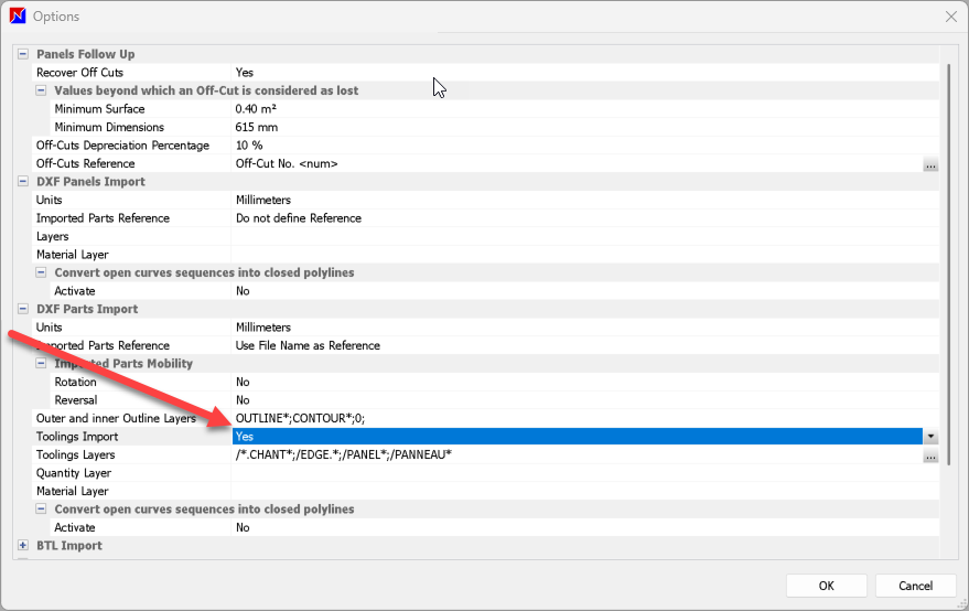

Caroline,
I have used your files and PolyBoard parameters and I am not having a problem.
Can you please check that your toolings import is turned on in OptiNest. See the following images:
Options.pngImage Enlarger
Toolings-import.pngImage Enlarger
If this is fine, please also send me your OptiNest parameters and I will look into this further.
