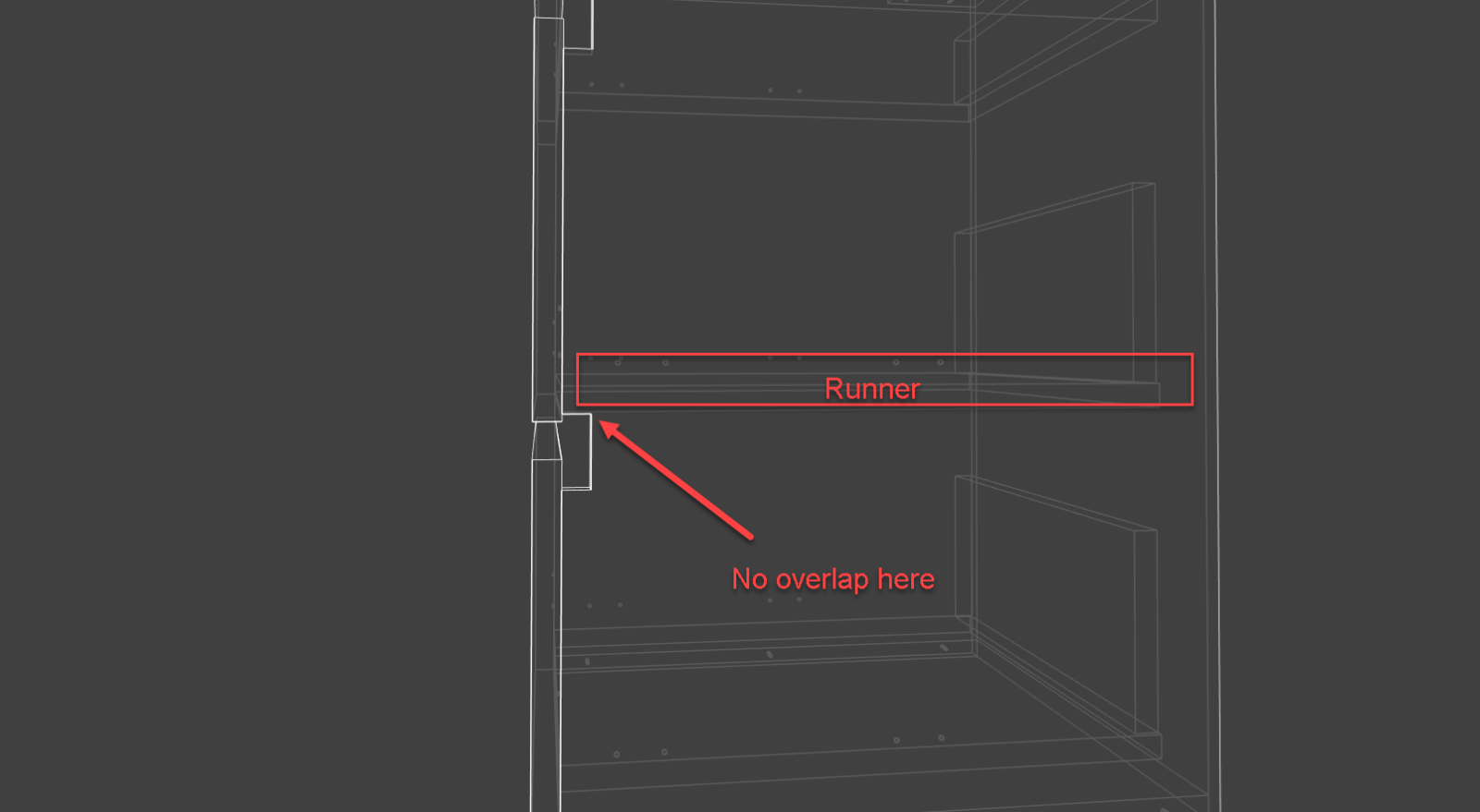

Hello Caroline,
The construction of this looks good to me. You will now need to confirm that the runner will not overlap with your notch. Its best to confirm the height of the runner to do this.
See the following notated example:
2026-06-26_14-51-19.PNGImage Enlarger

June 26, 2026 - 11:17 am
Hi Isaac
following on from our zoom session this morning i have done a cabinet with kubox overlay drawers with the 50mm knotches cut out in right hand gable can you take a look and see what you think?
Brendan is going to cut out the right hand gable anyway to see about the runners
Thanks Caroline
