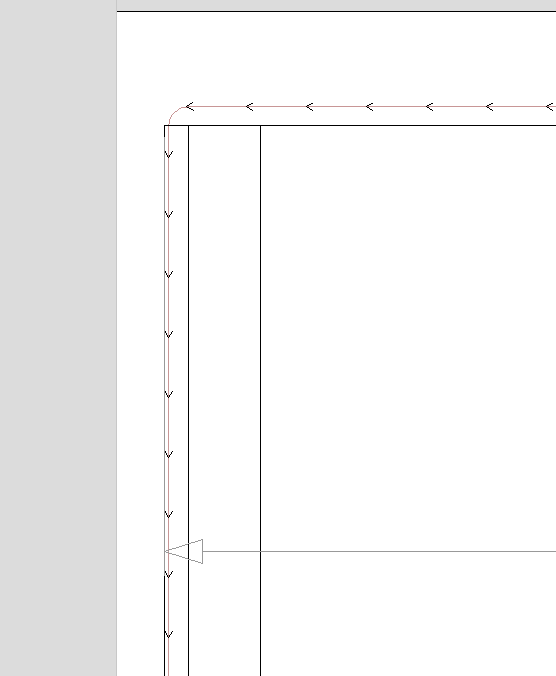

I’ve run the toolpaths again and I see that the toolpath is cutting to the inner size and ignoring the outer boundary. See attached picture and is therefore cutting the 5mm excess on each end away and therefore we are 10mm smaller than we should be.
Dermot

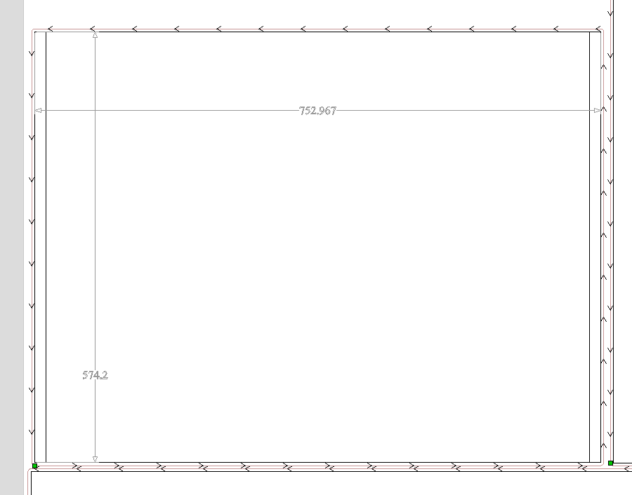

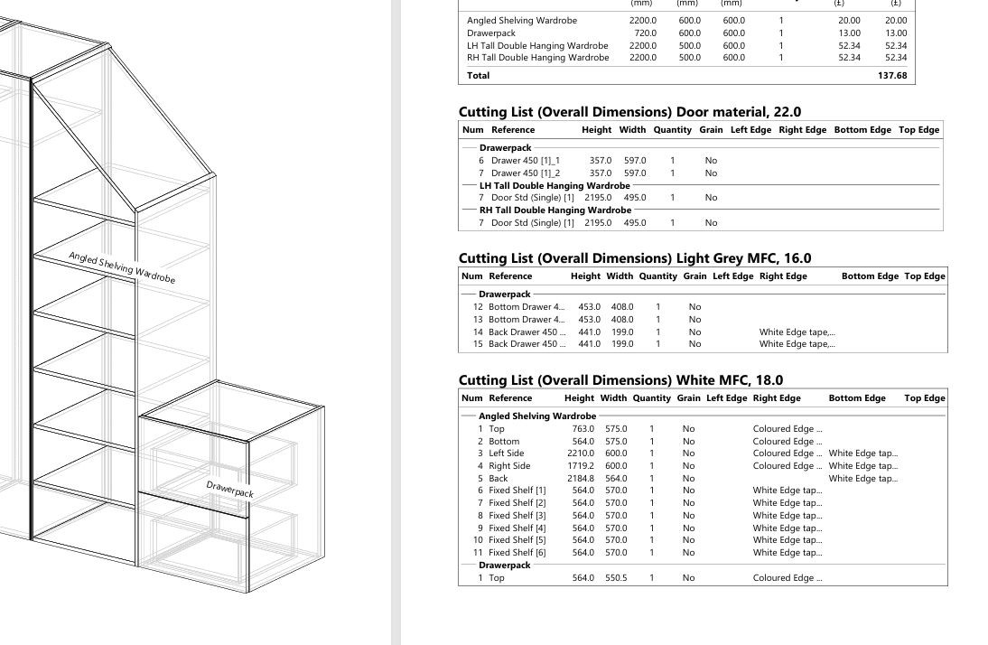

I’ve ran the job and the angled top should read 763 but the vectric file is being drawn as 753mm. Is there a setting to make sure that there is a trim value to allow for chamfering the panel?
Dermot
