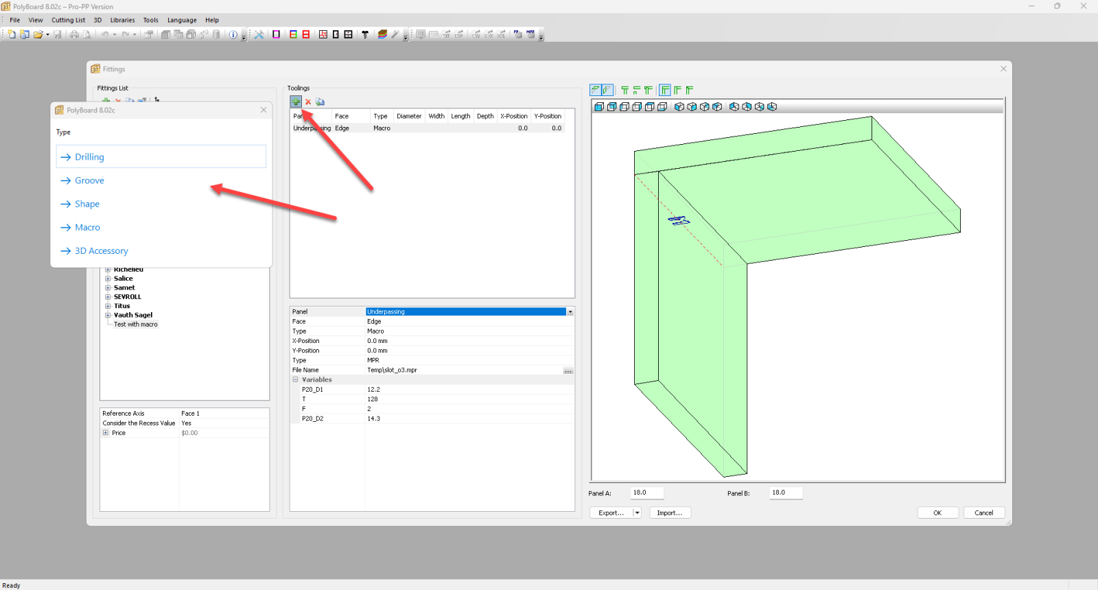

Tarjei,
If I understand you correctly, then yes this can be done.
If you are already using a macro in a PolyBoard fitting and it is working, you can add additional elements to the fitting. You can add additional grooves, drills, etc. within PolyBoard. See the following image:
Example.pngImage Enlarger
Please test all of this and confirm it is correctly working before machining.
