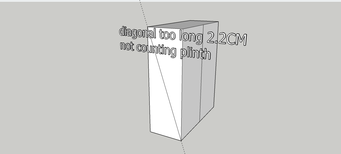

January 26, 2026 - 8:23 pm
maes2.pngImage Enlarger
So, ther was most certainly a project living.
You sent  me the files somwere in June i saw. But,
The diagonal was not correct. Cupboard could’nt turn straight into the living room. Measures were respected, . Yet the cupboard was 2.2cm too big (high)
I ve added an addittionel drawing It has nothing to do with plinths. I would like to know why the cupboard was to big for other projects of course..
Thx Bart

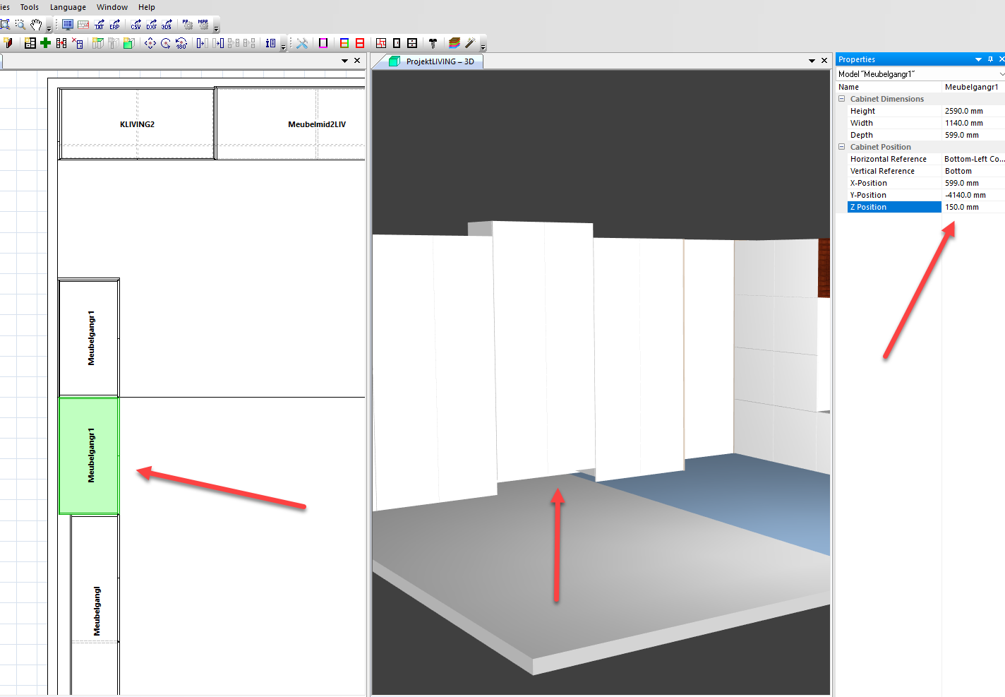

Forum Posts: 1452
January 5, 2026 - 8:10 am
Bart,
Are you maybe referring to a cabinets height from the floor? If this is the case, you can edit a cabinets Z-position in the project mode:
Plinth-height.pngImage Enlarger
More information can be seen on this here:
Project mode
