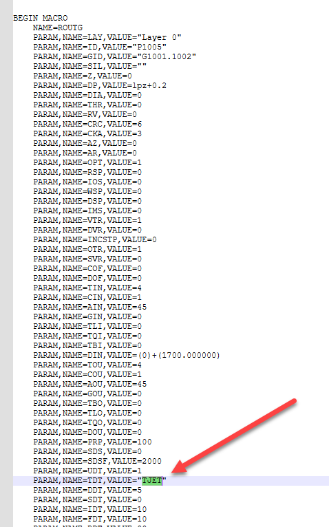

Hello Branimir,
See attached the program for the TJET with the routing macro. This is contained in the file that you provided me.

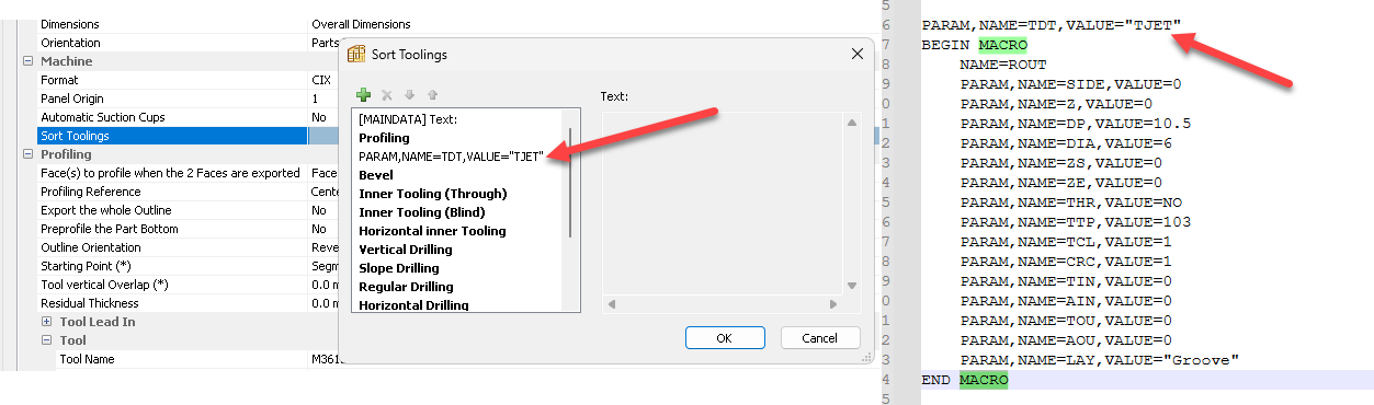

I have not been able to replicate this exactly, although have been able to place this before the macro from a custom text  pre-routing.
2026-03-31_13-14-15.PNGImage Enlarger
My assumption though is that this would not correctly work with your files.
Could you please provide the programming documentation for this? You may need to reach out to your contact at Biesse for this information.

Hi anyone know how to attach T jet deflector to post proccesing on Biesse CIX export?
