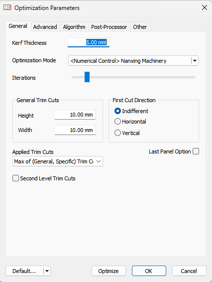

All parameters can be adjusted to suit your needs from within OptiCut,
para.pngImage Enlarger
Most important is your saw are well able to read test file, In principle, we do not supply any other files in addition to the test files already available on the site.
All the best, Alex

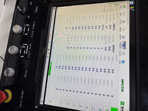

June 16, 2025 - 11:09 am
I attached a larger file so the picture is clearer.IMG_3558.jpgImage Enlarger
June 16, 2025 - 10:03 am
The image attached is not very readable, but if you send us an OptiCut *.ocp file we can send you a test file for your saw.

June 16, 2025 - 9:30 am
Hi Alex, is it possible to send a sample file with the attached parameters? I can confirm that the format file for the beam saw is compatible but when trying to do an actual physical test, it will not allow us. IMG_3558-1.jpgImage Enlarger
