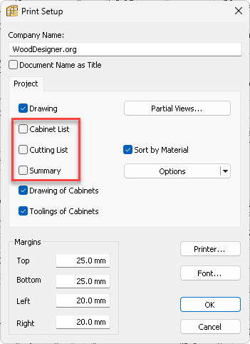

Hello Zaheer,
For PolyBoard, this data is currently paired with the Cabinet List and Cutting list information.
Your only options at this time for the PDF documents is to turn this information off.
2026-05-06_12-11-43.PNGImage Enlarger

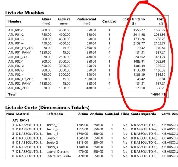

Hello , we have an issue: when I generate the PDF file from Polyboard, the cost of the cabinets appears in the list of cabinets and also the total cost by project, and I don’t know how to hide them. This is a problem because sometimes we share this PDF with customers, and we don’t want to share this information with them. Is there any way to hide and show it when we want to see it?WhatsApp-Image-2026-05-06-at-1.14.58-PM.jpegImage Enlarger
