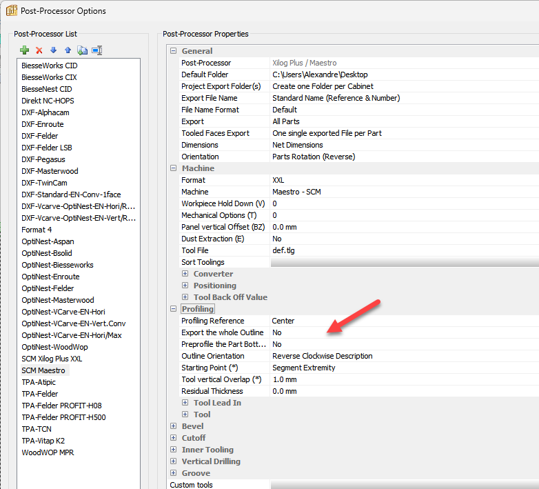

From my knowledge, for Nesting machine, PP option
Export the whole Outline , must be set to Yes to get part profiling,
But for Maestro, the Nesting already applied profiling looking part size, and this option must be set to No to don’t get twice profiling,
1 From PolyBoard and another from Nesting Module
Can you test and check this?

I am working with some project and i am finding hard to work like this with ISO began to get out again and with a lot of confusion between milling and drilling .I tried to make optiisation with maestro ,the first page comes good and then the work will remain the same .Other thing is the milling of polyboard and the perimiter rounding of maestro.There is a lot of doubel work with the chance that parts get moving .I cant work with this order for sure .Perimiter rounding or miling .i noticed that not all the parts had milling ,if so i can disabel perimiter rounting from maestro.
can you please help .
