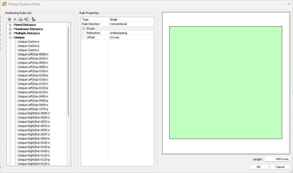

Hello Sam,
This rule is included in the QuickDesign Libraries if you are using them.
If you are not using the QuickDesign libraries, see the rule below. You will just need to quickly add in the values to a new rule as seen in the attached image:
Rule-2.jpgImage Enlarger

Hello Sam,
See the fitting links I have created in the following screen shots.
Note, to place on the right side of the cabinet you can either use the mirroring tool (recommended), or manually adjust the rule used.
Fitting-link.jpgImage Enlarger
Fitting-link1.jpgImage Enlarger
Rule-1.jpgImage Enlarger

Hi, can somebody assist me in how to use the salice air hinge into the carcass, they are designed that the hinge sits of the roof and base rather than the side gable and im struggling to create the rule for this work?
