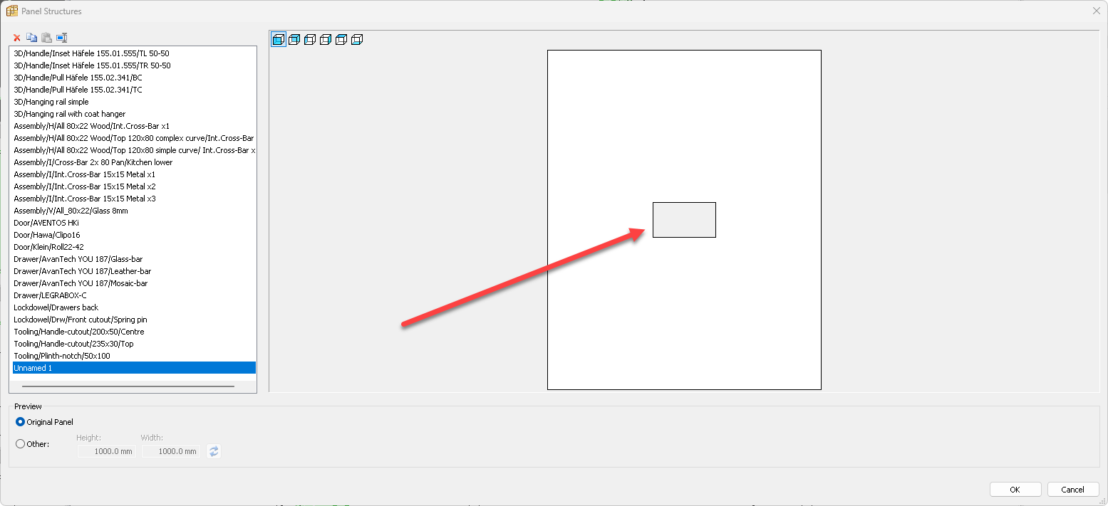

Here is a cabinet as requested,
Just an update my end, when I try add the structure to the library from the properties menu on the right it does not appear in the preview window.
However I just noticed when I add it via the edit tab on the top left menu bar it does appear within the preview window when the menu pops up.

Forum Posts: 1441
sp_UserOnlineSmall Online
May 21, 2026 - 9:19 am
Good morning Keith,
I hope that you are well.
I have reviewed this cabinet and the results I see are the same as Alex in the video below.
When I save the structure I am able to add it into other cabinets.
When you are saving a structure to your libraries, are you able to see it in the preview as in the following image?
2026-05-21_09-17-54.PNGImage Enlarger
