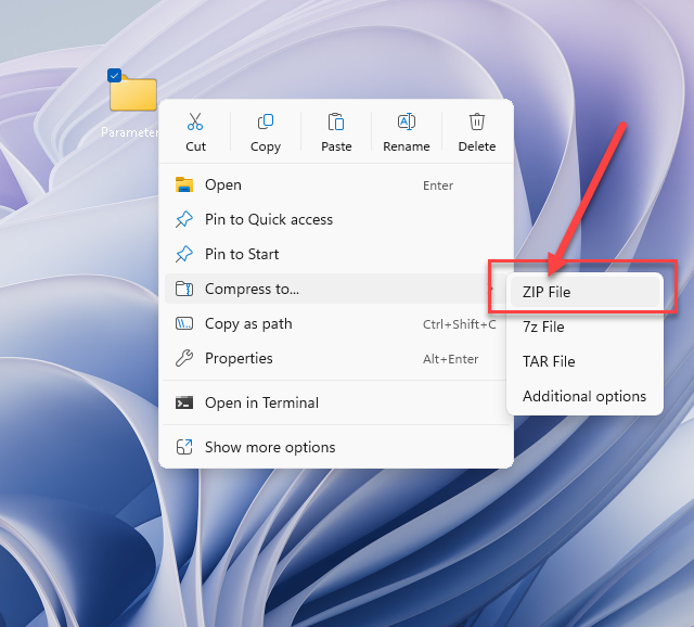

You need to compress this file before it will allow you to attach it. Please save the parameter file in a folder, right click on the folder and compress it to a zip file. See the following image:
Compress-to-zip-file.pngImage Enlarger
This will allow you to upload the file. Please do not save textures in your parameter file.
