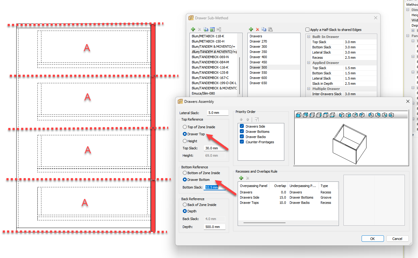

With regard to case number 1, please note that your sub-methods refer to the interior zone. The drawer boxes will be as tall as possible, with the height determined by the slack in the zone.
Zone.pngImage Enlarger

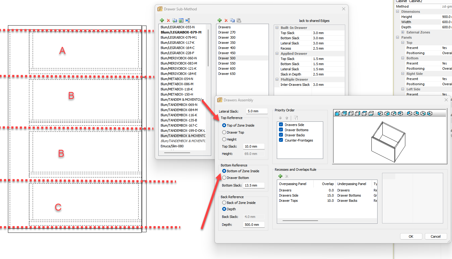

Then, looking at the second case, defined on drawers, we are talking here about the front, so you will get identical and interchangeable drawers, but you will then need to take into account a larger top and bottom slack that could potentially cover the top or base of the unit, but will also result in smaller drawers.
Drw.pngImage Enlarger
Hope this helpful, Alex
