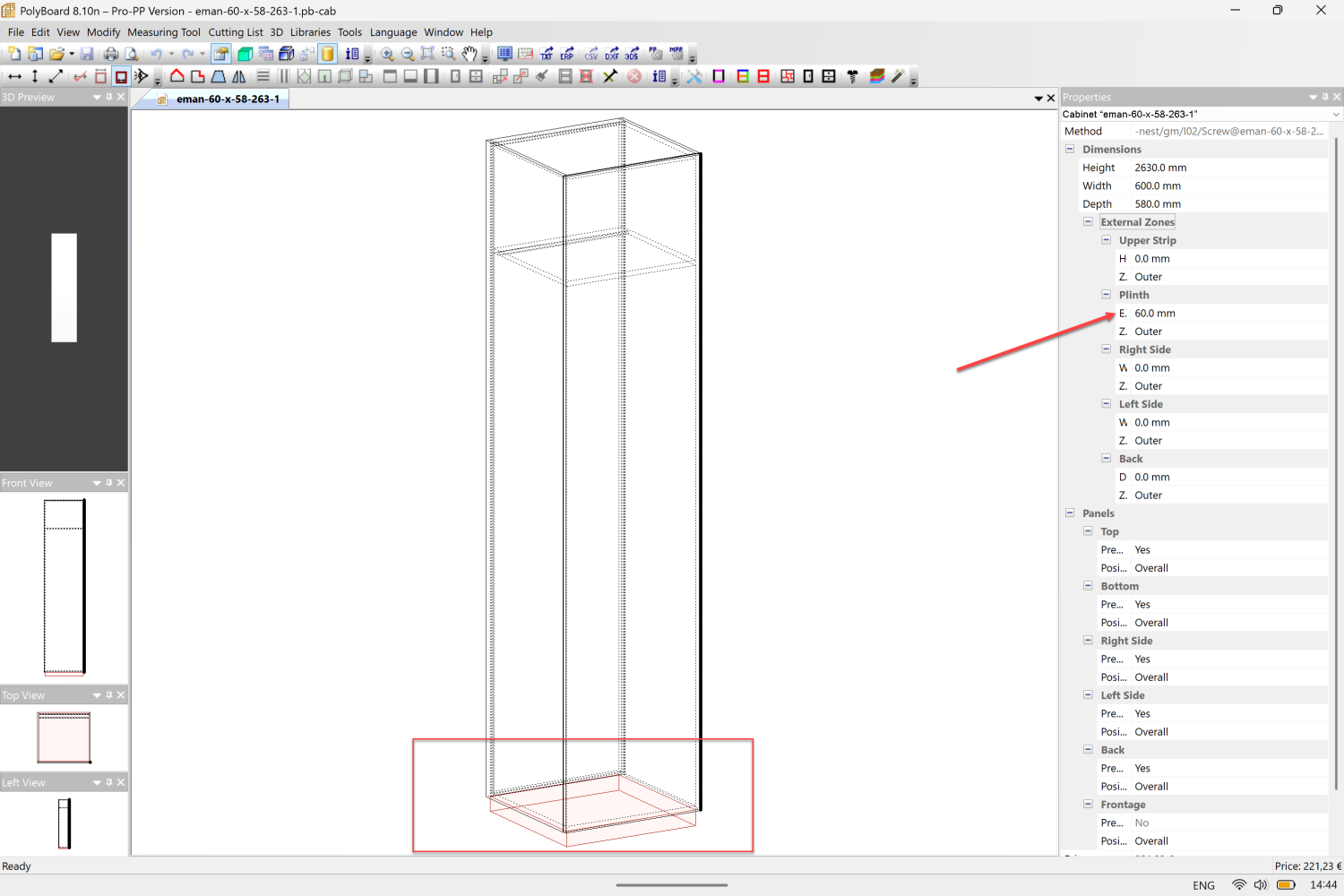

Hello Emanuel,
I can see that you have added an external plinth area, reducing the height of your cabinet by 60mm. If you set this plinth area to 0mm, this should resolve your issue.

Dear
i had this file that the measerments read well but the work come shorter .Can you please tell me what i did wrong .
