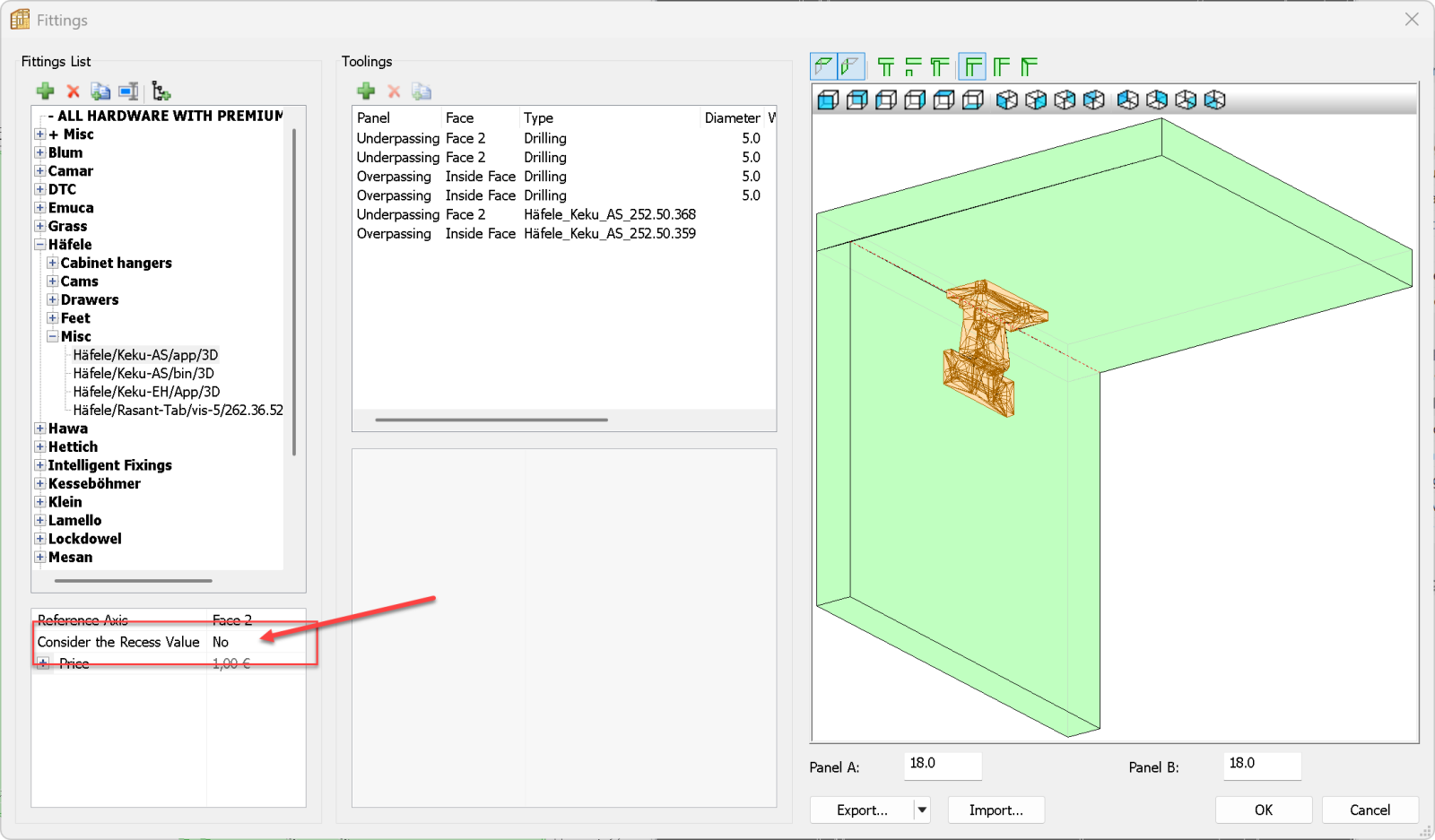

I am glad that worked for you. Let me know if you have any further questions.

Thats the one. Didn’t look like that setting was doing anything initially.

Hello Dean,
If I have understood you correctly, you need to set the fitting to not consider the recess value. See the following image for your fitting:

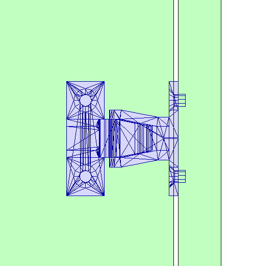

Hi folks,
  I am aware that you can change the slack on doors and drawers to space them from cabinets. On some items such as runners and hinge, it is not so much of a problem to not adjust this as the slack moves up and down as they have adjustment when installed. Some fixings however, do require adjustment in manucaturing to maker it sit right in practise. Please see below;
keku.pngImage Enlarger
This keku fixing (using your harware packs) sets the fixings back 37mm… This means the door snaps shut right on the cabinet with 0 slack. Even when the slack is increased, the distance does not change.
Is there a way to adjust the fixing so it drills fixings dependent on slack? ie. 37mm+2.5mm… Or do I have to adjust this manually?
Dean
