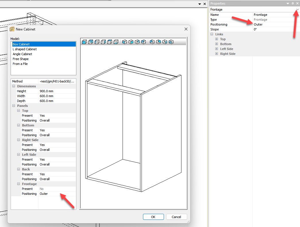

Absolutely, there are two solutions.
– When creating the cabinet in the first window, define the frontage in the Outer.
– Or, when your cabinet is already created, from the properties, select frontage then define it to Outer.
outer.pngImage Enlarger

Hi
can you teller me how to stop
a cabinet from resizing after I add the door. I want my cabinet to be 600mm depth + the door not with the door.
thanks
