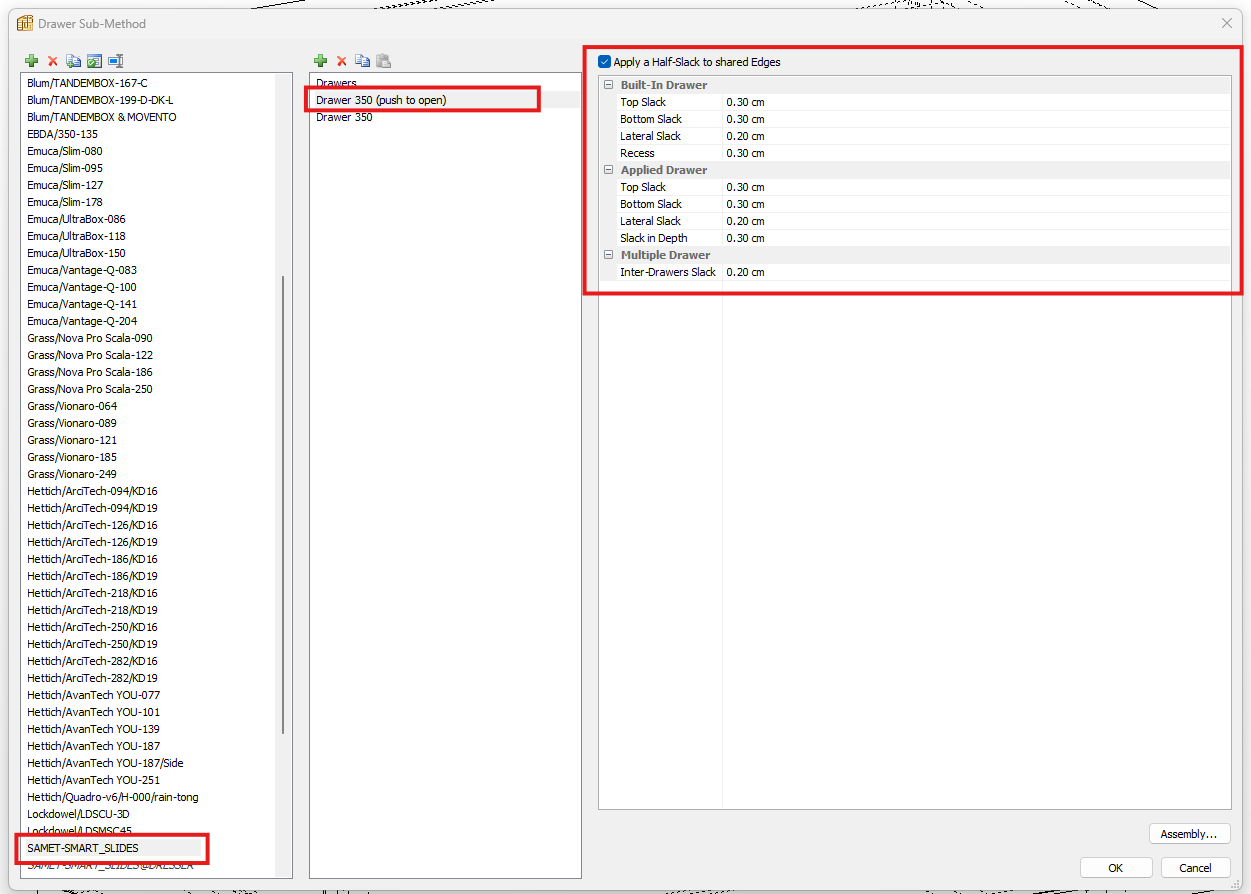

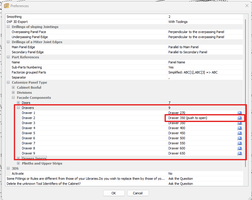

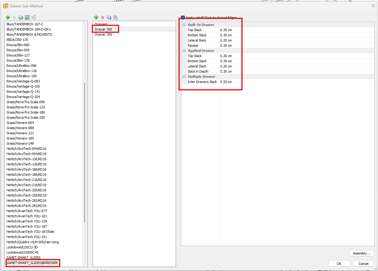

Thank you again for your support, I have finished the drillings for the slides and i have a few things that i want to ask about:
1- in the drawers nameing
we have added before the push to open title to the list but i can`t find it althought the setting are already found in the 300mm
I want it to be the same 1.pngImage Enlarger
2.pngImage Enlarger
3.pngImage Enlarger

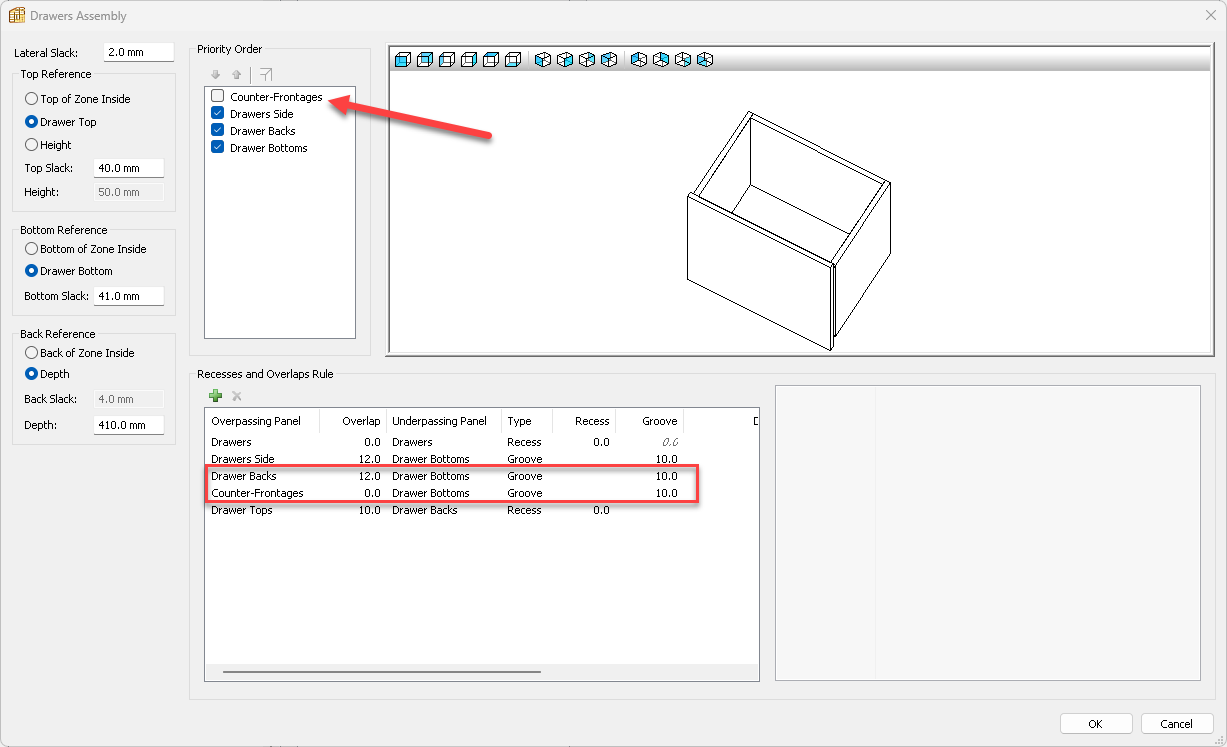

Hello Hassan,
You may be right regarding the A and B drillings. If you don’t believe you need these, then you can remove them from the fittings.
Regarding the grooves for the drawer bottom, this is possible. You need to:
– Make the counter-front the highest priority (even though it is a nil material)
– Add the rules highlighted in the following image (with your depth requirements)
Grooved-drawer-bottom.pngImage Enlarger

everything on the software is fine except for few things, I am sorry for that but the problem is that we are going to change the slide to Smart Slide single extention Drawer lock fix 350mm + 450mm
As I can see from the tech. sheet it`s the same except we don`t need the A+B drillings and please confirm that for me.
the main issue is that we use 3mm panels for the drawer bottom so i need it to be grooved, it`s fine i have made it with the sides but i couldn`t do it for the frontage, also for the back, I think for the back if we can`t make it grooved can we make the bottom overpassing the back so we can make it fixed with screws?
I am looking forward for your reply,
Thanks in advance
