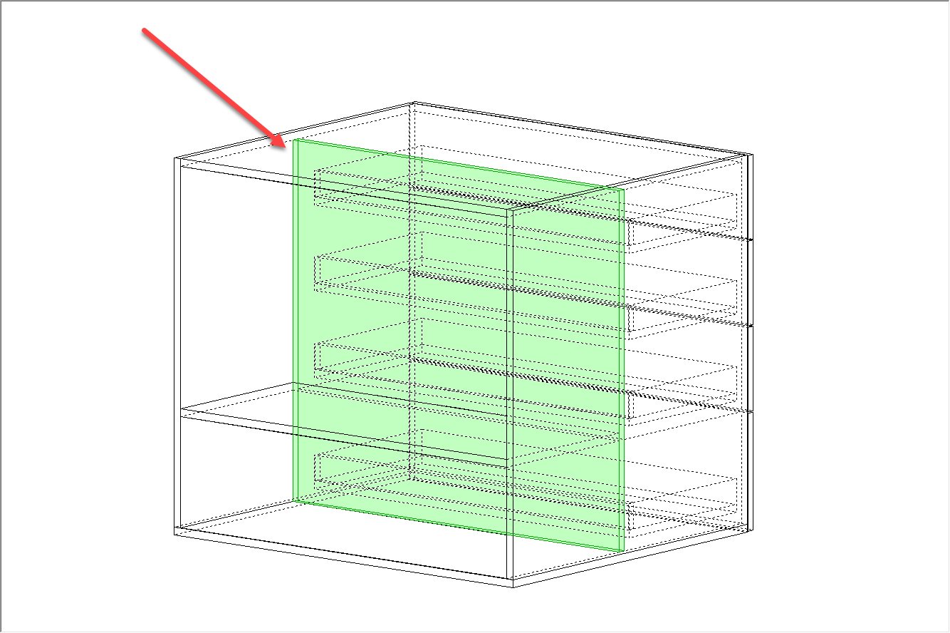

Emanuel,
If you remove your back panel here, and add it back in as a Double-Back, you will then be able to add drawers.
2026-03-03_09-33-42.PNGImage Enlarger

March 3, 2026 - 8:46 am
Dear
sorry for late reply i was abroad .
Regarding the chest file ,i had this doubel chest and one side of it was easy to put drw ,on the other side i cant because the space is coming in red .I know that i had something wrong but not sure what i have .
thank you
regards
es
