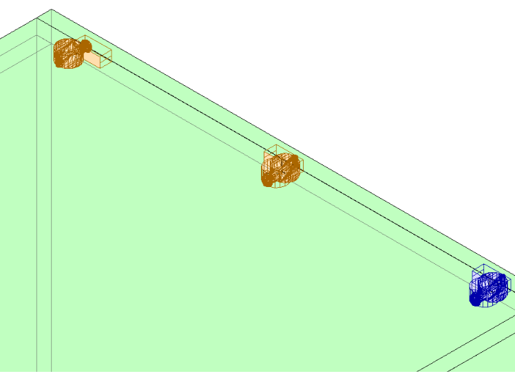

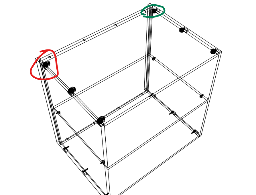

Hello Zaheer,
The problem was resolved in a previous version, although this has been retained by your fitting.
The solution would be to delete the 3D accessory from the fitting, then to add it again, and this should lead to a stable solution.

I noticed that in PolyBoard 8, some 3D accessories in my fittings rotate unexpectedly. In the “peanut” attached photo, the Peanut fittings are oriented differently even though they use the same fitting.
I also tested this on a simple box with basic left and right panels. On one side, two accessories rotated while the third did not. Is there a reason for this behavior in PolyBoard 8?
I attached my cabinet and the 2 photos axamplesPeanut-rotation.pngImage Enlarger
