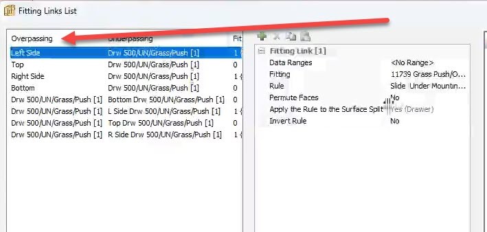

Hi Nadeem,
This follows the same reasoning as my previous post.
In the first image, you can see the fitting link when the drawer is initially added. At this point, the drawer front is the overpassing panel.
Overpassing-drawer-front.jpgImage Enlarger
However, once you add a door, the drawer automatically becomes built-in so the door can sit in front. As a result, the drawer side becomes the overpassing panel instead of the drawer front. The second image—taken from your video after the door is added—illustrates this change.
Overpassing-left.jpgImage Enlarger
That’s why the fittings are referencing differently; the overpassing panel in your design has changed.
I hope this is helpful.
