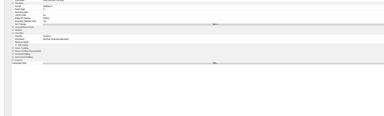

Doesn’t seem to be the ‘ignore’

John,
PolyBoard 7 will have this labelled as “Chamfer”
See attached:
Chamfer.pngImage Enlarger

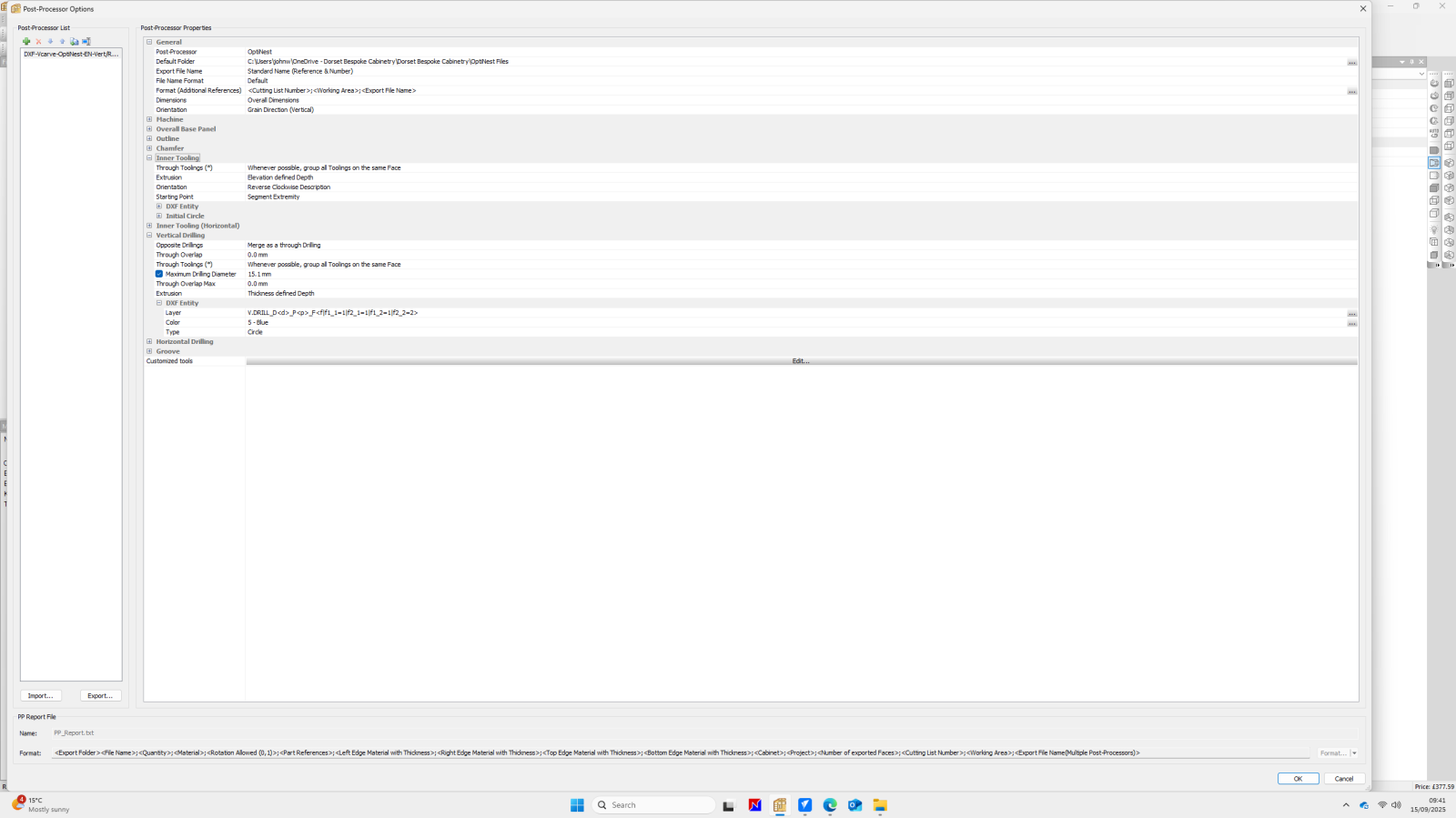

I cannot seem to find the ‘Bevel’ on the DXF options.
See screen shot.DBC.pngImage Enlarger

Good morning John,
I believe that your issue is regarding the bevel on the top of your cabinet.
In your PostProcessor, if you choose to ignore the bevel, this should resolve your problem. See the following image:
image.pngImage Enlarger
