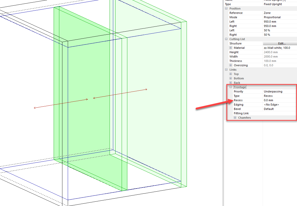

1. Use the properties to recess the upright from the front of the room. Note, this will still split the zone of the cabinet completely.
2026-07-31_08-16-23.PNGImage Enlarger

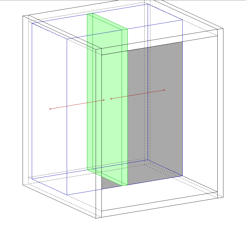

2. Add a double back and make this a nil panel. Once this is a nil panel, add a upright in the inside zone.
2026-07-31_08-17-43.PNGImage Enlarger
