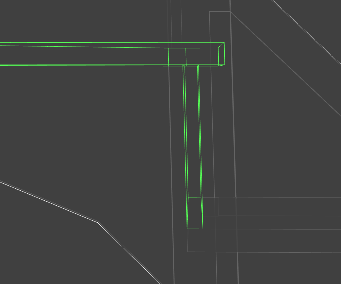

Ah ok, thanks for clarifying that. I didn’t realise I hadn’t included a groove at the top of the riser going into the bottom of the tread so I’ll make sure I cut one in and add that measurement onto the riser. AS for the bottom of the riser what do you recommend there? Is it fine to just sit it on with out a groove there?

Hello Craig,
In the file that you previously sent, the risers are just sitting above and below the treads, flush with the back edge with no groove or recess. See the following image:
2026-04-16_13-09-17.PNGImage Enlarger
Does this help?

I have a quick question about building the stairs. Does the back edge of the treads where it meets the bottom of the riser have a rebate or groove for the riser to sit in or are the riser just sat on the back edge of the tread and screwed from underneath?
Craig
