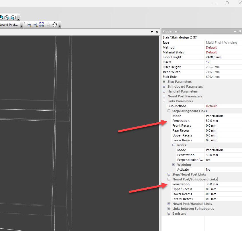

March 2, 2026 - 9:03 pm
Hi
Isaac said
Hello Craig,
You can adjust these in the parameters. You will need to adjust both the step/stringboard links and the newel post/stringboard links.
See the following image:
Thanks for the information. I’ve adjusted those parameters and gone through the other parameters in the links section. Is there anything else you think I need to take into consideration? Do you think the joinery will be ok and not clash in any parts?
I’ve attached the updated design.
Thank you
Craig
March 2, 2026 - 11:50 am
Hello Craig,
2026-03-02_11-47-30.PNGImage Enlarger

March 2, 2026 - 10:19 am
Isaac said
Hello Craig,
Two more points to consider:
1. This project has standard strings, not cut strings. Cut strings are internal stringers placed under the steps, rather then externally placed as yours are.
2. I can see your steps are penetrating 30mm into the strings. The stringboard is only 32mm in thickness. Please confirm if you are happy with this design.
Thanks for the reply. I didn’t realise they penetrated 30mm. I think 10mm would be better. How do I change that?
Craig
March 2, 2026 - 7:09 am
Hello Craig,
