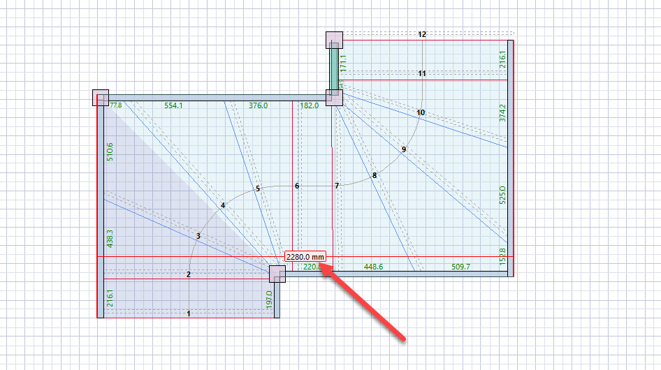

1. Overall width does not measure as 2430mm.

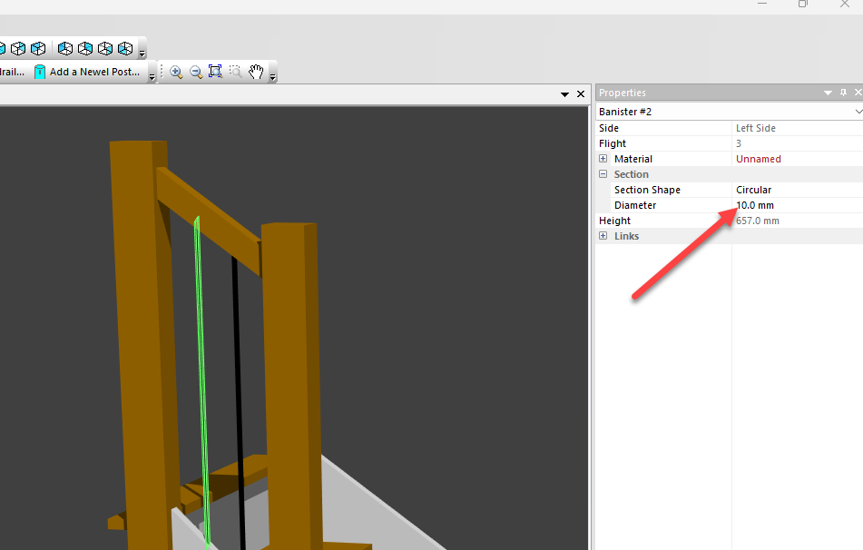

2. Banister diameter is not 14mm.
2026-02-27_09-24-32.PNGImage Enlarger
Please confirm/adjust as you require. Let me know when you are finished and I can provide you the files.

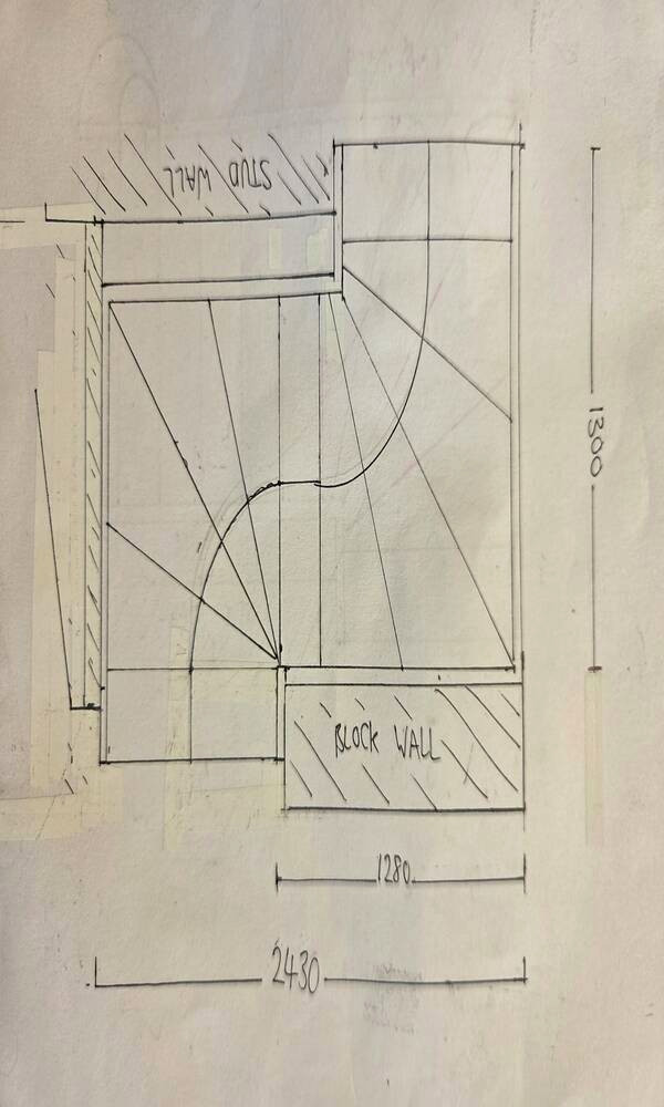

I would appreciate a technical review of the attached StairDesigner file prior to StairFile generation.
Details –
Floor-to-floor height: 2480 mm
Structural opening: 2430 x 1300 mm
Configuration: Double Winder
Strings: Housed both sides
Treads: 22 mm oak
Risers: 18mm ply
Handrail and 14 mm round metal balusters
Please confirm:
Geometry compliance (rise/going/headroom)
String sizing adequacy
Any recommended adjustments before manufacturing output
A to-scalersz_1final_stair_plan.jpgImage Enlarger
plan is attached for reference.
Thank you.
